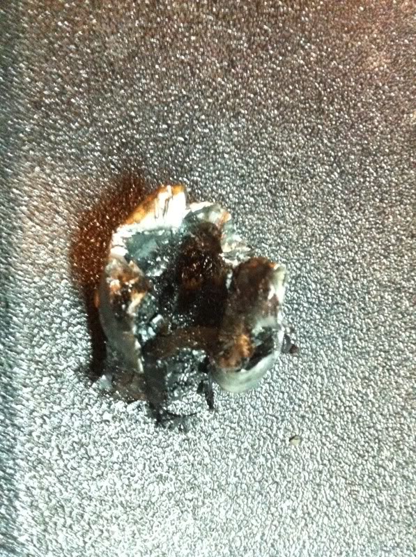

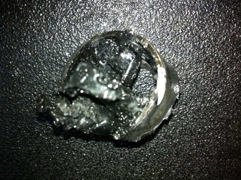

If your thinking of replacing your rotoflex joint and want to replace the coupler seal/sleeve, make sure you have the right tool!
Here is how mine looked after 3 hours of painstaking frustration, utilizing every tool a Audi dealership has to offer. Including 3 different slide hammer bearing removal tools, hammer and chisel, air hammer which broke 2 bits. What finally got it out was the hammer and chisel breaking into a couple pieces. I am sure Land Rover has a removal tool, or and driveshaft shop.

If you apply heat they usually come right out. They are fitted using loc-tite that specifies heat to remove.

No loctite on this one, did apply ample heat. It was rust seized in place.

I have replaced mine a couple of times and it has not been an issue with a good sharp chisel and hammer.

Thats what ended up doing it for me. So everyone listen. Sharp chisel and hammer. Stay away from the power tools and fancy pullers.
