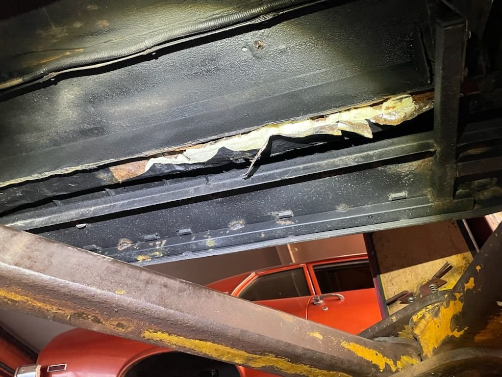

Hello. New to this forum. Recently scammed by RoverClassics.com. Bought a 1999 Land Rover Discovery 1 for 11K from them. Advertised as "absolutely no rust". On first drive the steering wheel started to rattle, car wouldn't accelerate, transmission shot. When I finally got it to a mechanic he said the frame (back half) was rotted through at the suspension joint. He could stick his finger through it. They'd rigged it with foam spray and heat tape and spray painted it to disguise this.
So, now I am wondering whether it makes sense to scrap this car for parts or repair the frame. If the latter, any suggestions?

Here's the initial diagnosis from the mechanic: 1. Transmission shot. Needs to be replaced or rebuilt.
2. Frame - Back half through rotted at suspension joint
3. Engine runs strong but high miles (170k)
4. Body is very good (except floor panels - can’t remember the word for them - both rotted out and need to be replaced)
5. Exhaust needs work. Muffler and connections rotted through.
Thanks for any suggestions.

Can you post some pictures of the frame rust? There are many on this forum with a lot of experience with these vehicles and repairs. I have four disco 1 frames, none have bad rust at the back, but one does have a rotten frame at the front. Odd place as these things seem to rust coat themselves at the front.

Sure thing. Her's my brother recording what he found. He's a mechanic. I had it towed to him. He was blown away. Heating duct tape, foil, foam.. Attached movie and some photos.

One more photo here. I could understand a little bit of rust, but this was clearly rotted through and attempts were made to conceal it using tapes and foams. That's what is concerning.

maybe this can help..
https://www.roversnorth.com/parts/pl...y_ii_1999_2004
There is a place in U.K. that makes up replacement sections, just can't remember where..
