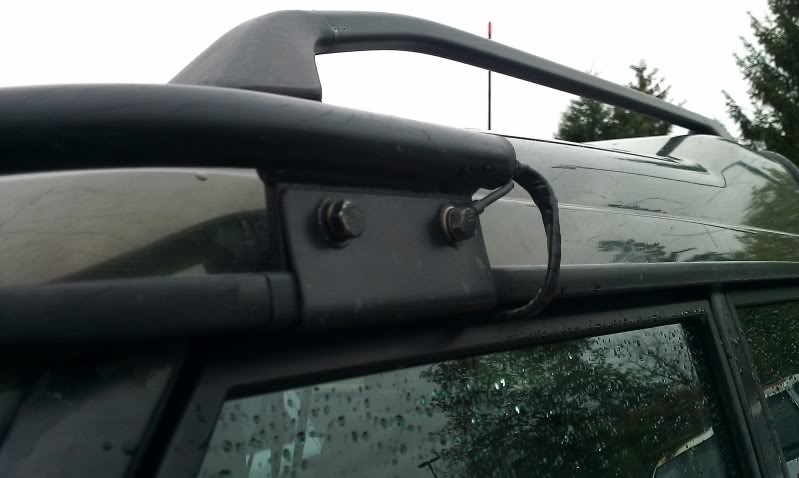

Here's what I did.
On the drivers side, peel off the weatherstripping around the top of the door frame. I took a dremel and cut a notch in the steel for the wire pass through. Ran the wire and reinstalled the weatherstripping. Continued to run the wire down the A pillar behind the trim and to the switch/relay. No leaks.
Here's how the end product looked.

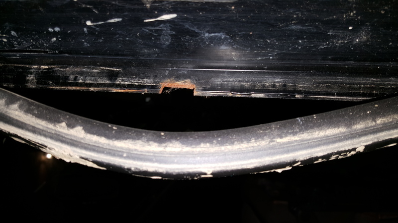

This is thw notch I made. There was a corresponding notch into the non-sealing part of the weatherstripping, but I've since replaced the door seals.

So does water run in at all?
Old Nov 7, 2015 | 09:51 PM
fishEH's Avatar
Joined: Nov 2009
Posts: 4,079
Likes: 227
From: IL
Nope.
