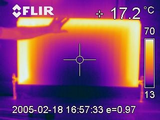

With age of truck and the large copper radiator it may have a build up of scale inside that reduces the heat transfer. Add the load of the AC (summer in your half of the world) and it may be too much for the system. A couple of simple tests - open the top fitting and shine a flashlight down inside, looking at the ends of the rows of tubing, my 97 had so much scale you could see it coming out the end of the tubes. Also you can warm up the truck, and check temperature with an infrared thermometer of the fins top to bottom with truck off. More than 10F difference makes you think there may be some build up. I have tried commercial flush, white vinegar, and even removing radiator and soaking inside of it with muriatic acid up. None of those got the result of taking the radiator to a small rad shop that handles tractors and construction equipment. The Rover radiator is so small they don't charge much, they unsolder a tank, use rods to knock out the calcium, solder back up, check for leaks, and hot flush with citric acid. It works like a new one. I paid $75 US.

The temp you are runing is dangerous to the engine, can take out a head gasket, crack a block, make sleeves begin to slip. The gauge is not very precise. A scanner will show you exact numbers, and you can easily see if you are making progress. No need to go to 235 F.
Attached Thumbnails Scary News!-rad-crud.jpg   Scary News!-sludgerad.jpg   Scary News!-p1120320.jpg
