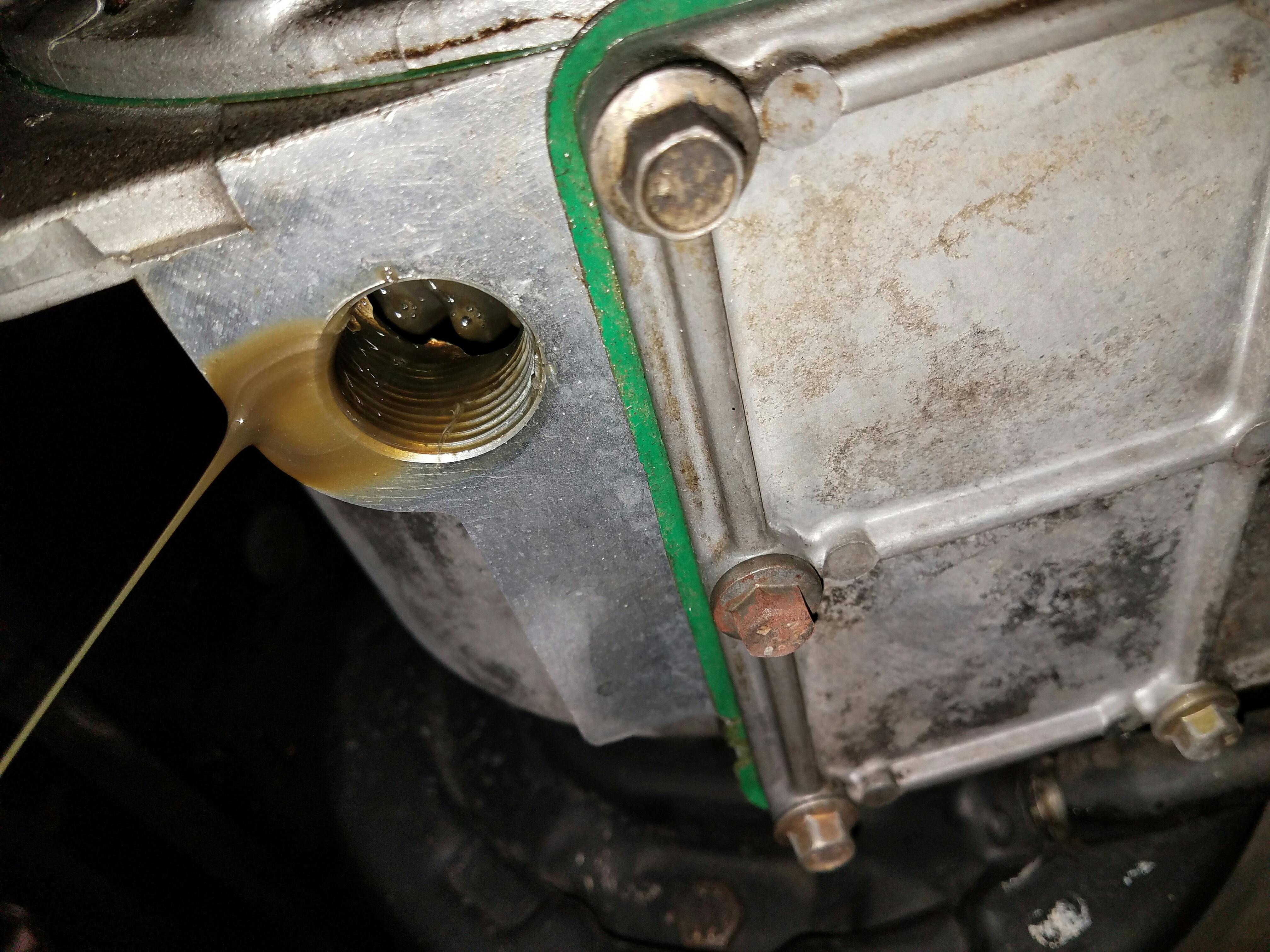

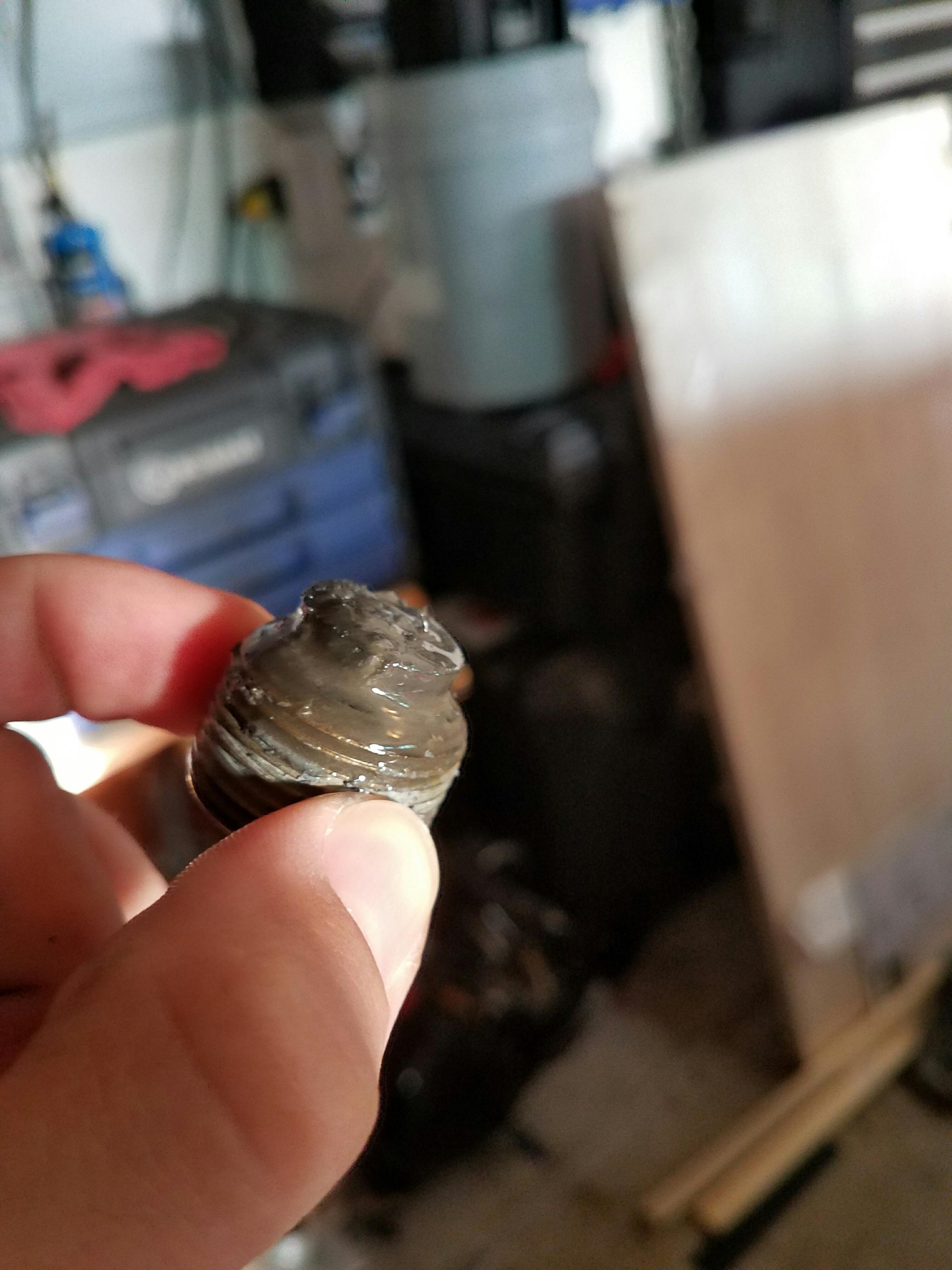

Fast forward to this week, started noticing a single solid clunk on quick acceleration and deceleration. Did a little research and found recommendations for low t-case fluid and to just top it off. So i get under the truck this morning, remove the fill plug, stick my finger in to see how low it is, and I notice that it's only about 1/4-1/2 inch below the fill plug. However for being a year old it seems dirtier than I would expect.

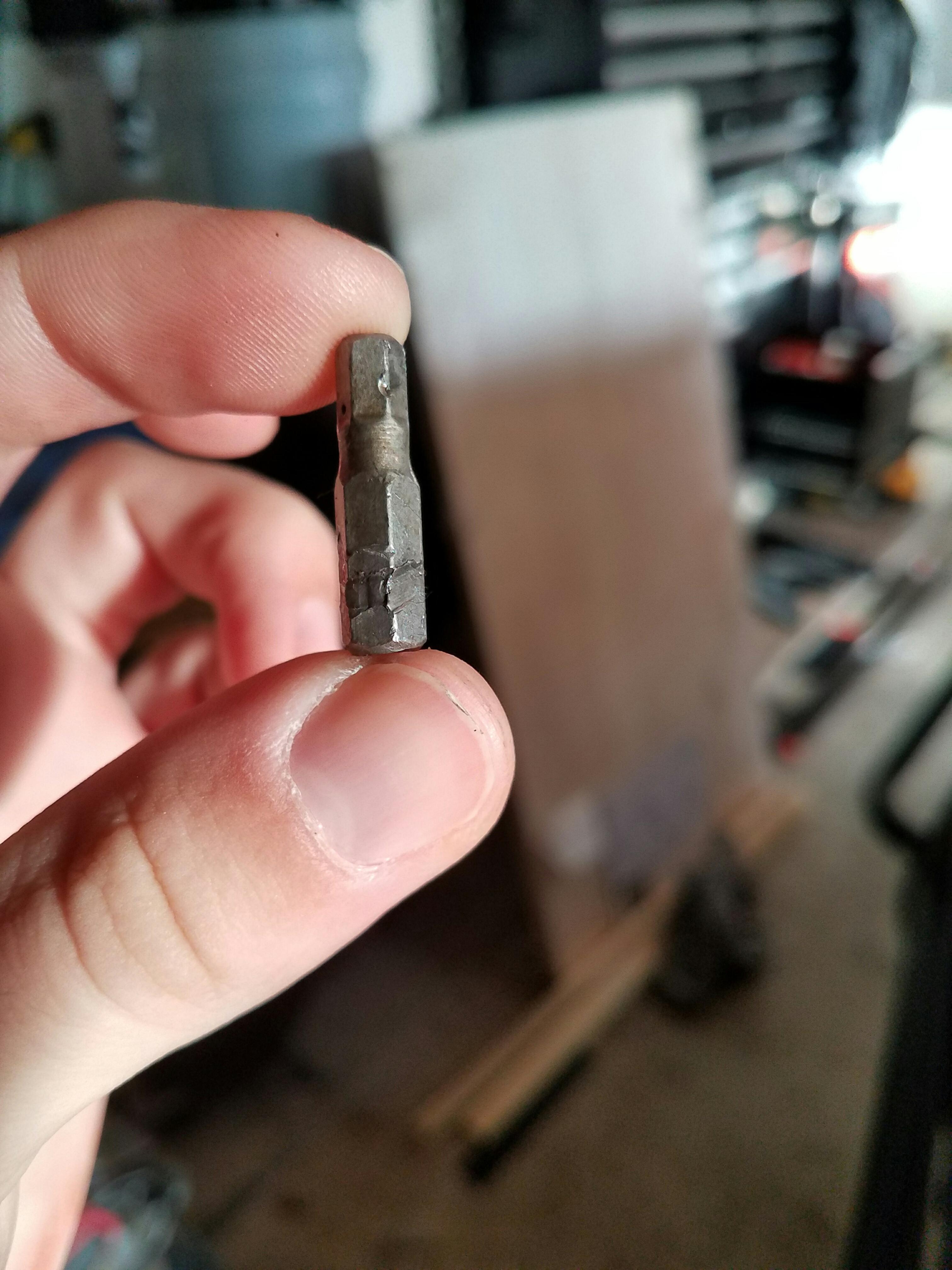

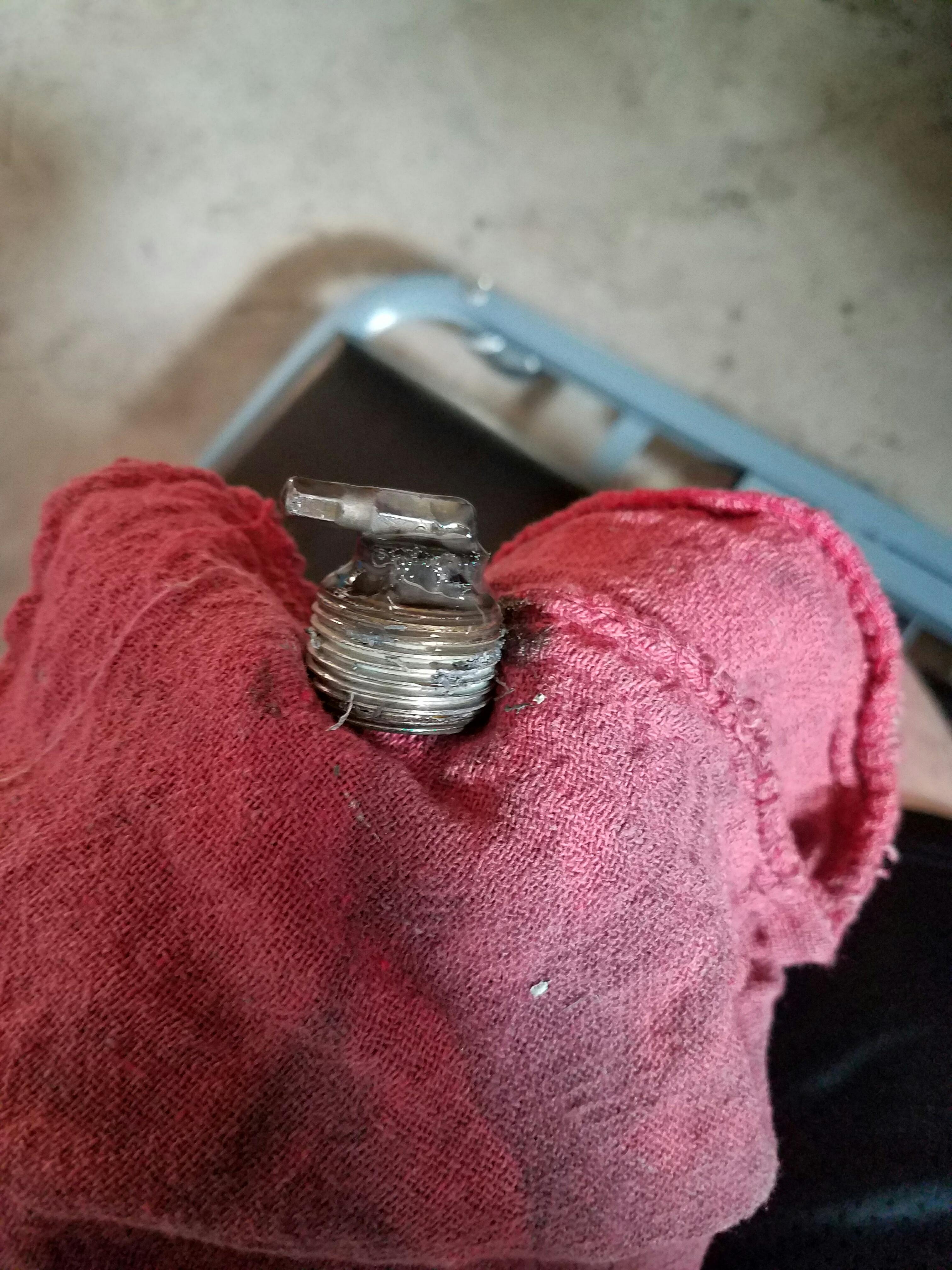

So, I pull the drain plug and low and behold, it's my missing bit... FML. The bit has some damage so it obviously made some gear contact. Curious on what y'all think?
Pull the t-case and reinspect or should be fine, fill, and drive?

Fill and drive, see if the noise is still there. Oil looks kinda milky, do any water crossings?

Only a couple, but neither even touched the door sills. That milkiness is what tempted me to drain it in the first place. Still have the oil in the pan, I'm going to filter it tomorrow and see if it provides any insight.

The bit didn't look too bad, whatever it snagged shot it out quick, like Walt mentioned I'd have a looksee at the gears to make sure no teeth are missing/chipped. Hell, it's an LT230, bulletproof transfer case if there ever was one, rivals the Dana 300.
