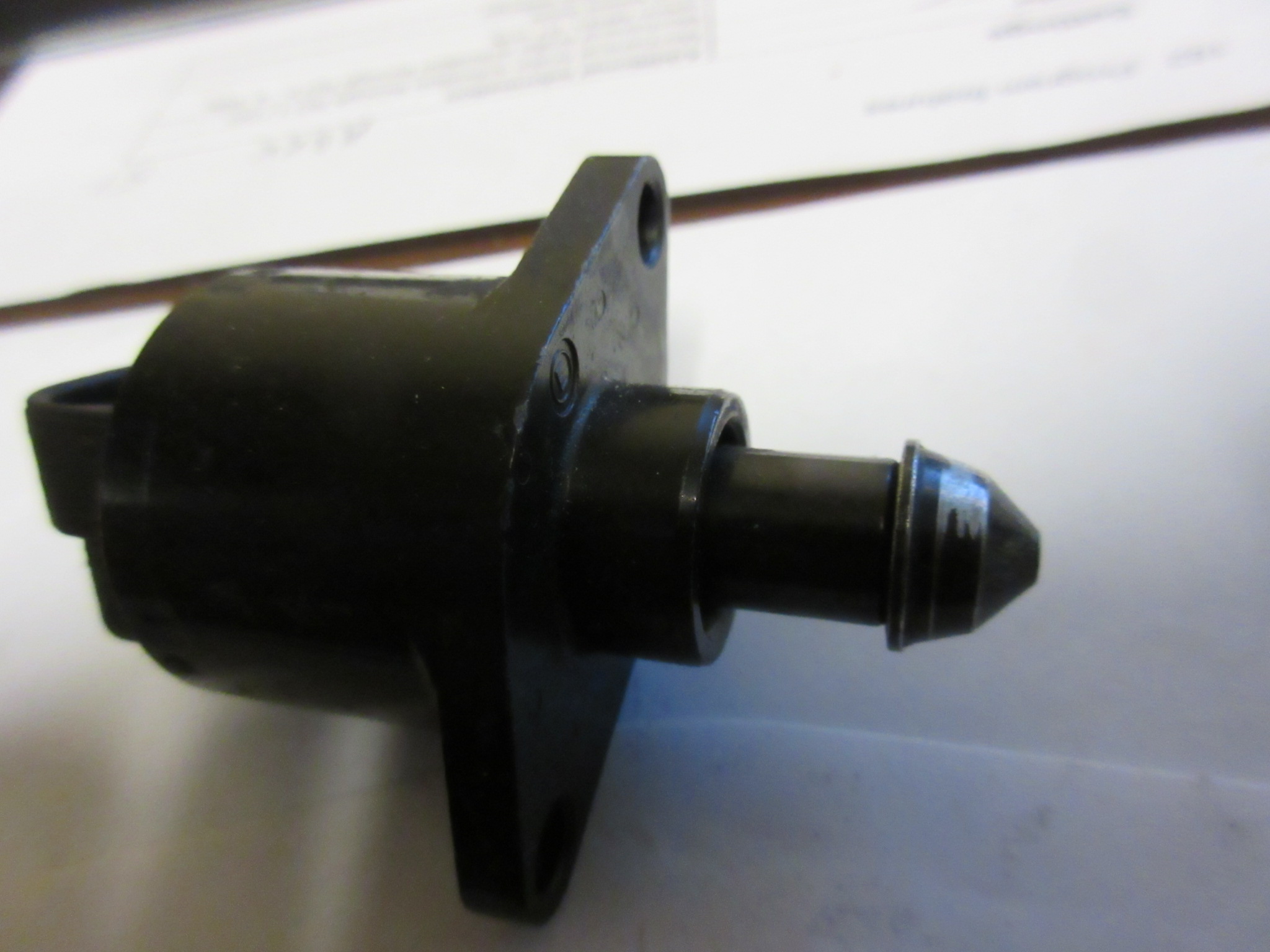

3) Idle: I think your husband is onto something with the vacuum hose problem. In the engine compartment by the drivers fender is a vacuum line that goes through the firewall. That line often rots and is easy to miss. Put a vacuum gauge on it, should be 20 in of mercury and steady ...or in that range of 18-21 ...whatever the book says. Worst case plug all the vacuum ports and then try it. There is the IAC (Idle Air Control) valve which controls idle. Might remove and see if it's plugged or working.
