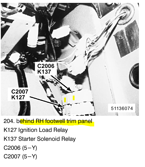

RH Footwell, see pic
Is this for a 1998 Discovery, my husband is saying the location of our panel is different, he says ours is under the glovebox behind the dashboard.
