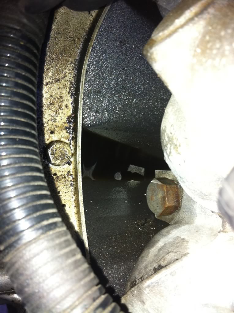

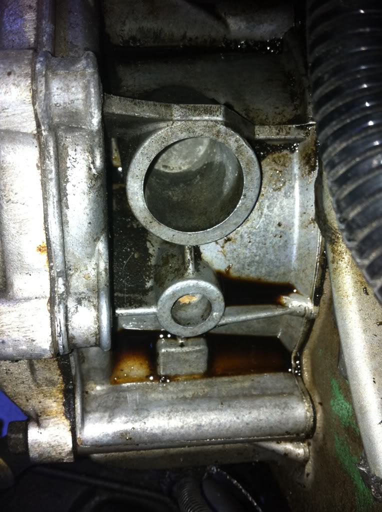

Well I have two threads going, one about braking and one about an oil leak... I seem to have posted an update on my oil leak in my brake post
Anyway, a 12pt 8mm 1/4 drive socket cannot be found.... I guess I have to special order it. Has anyone tried 5/16 or 11/32? Anyway, I have an 8mm 12 pt socket in 3/8 drive, but it does not fit in the cut-out.
Some folks suggested that I should sinch down the the outside ones, but I think I am having problem with the inside as well.
This oil leak is SEVERE!!! When I worked on the brakes, there was a significant amount of oil build up on the bottom. Good news is that after years and years of soaking in oil, there is virtually no rust down below
Here are a few photos of what I have going on....
Oil leak pools up on the water pump as well as on top of the block, underneath the intake manifold.

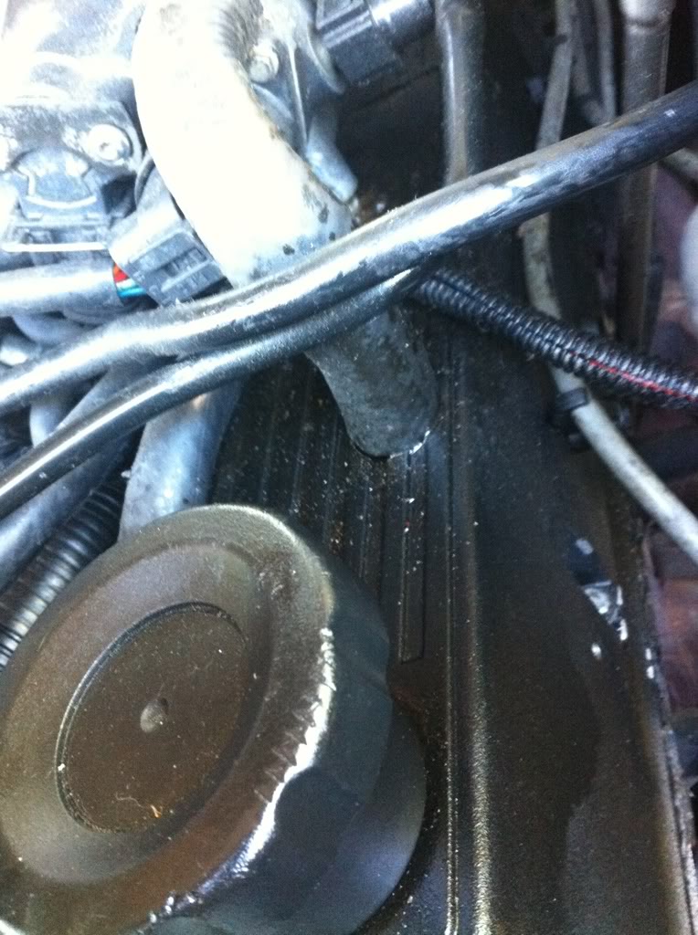

A good amount of oil ON TOP of the valve cover.... Not sure how it gets there.... But its there.

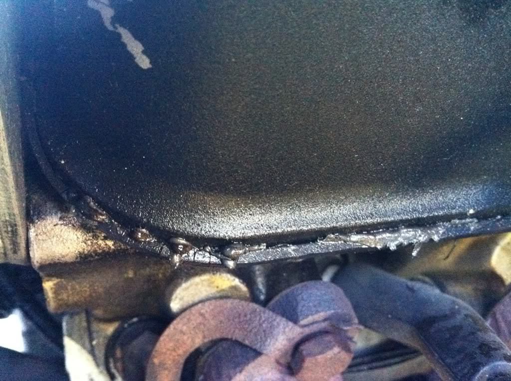

Maybe its a bad gasket? This black silicone junk looks suspect to me.

Still think its valve covers? Or do I have something else going on?

Looks cleaner than mine. And the 8mm 12pt I bought is already necked down, and 3/8 drive. Works good. The 1/4 inch drive may be making it hard on you to find.

Looks like maybe someone was in there possibly and tried to take care of a leak with the RTV?
I had more oil than that on top of my water pump and thought it was the valley pan gasket, even bought all new upper gasket set before I found a socket that would work. Like I said, I used the 3/8 drive from NAPA.
Do you have a bench grinder? You could take some material off the outside of your socket to enable it to fit since you are having difficulty finding a socket. I went thru quite a chase here in Pittsburgh only to get that one from NAPA. Even ordering it, only a 3/8 drive was available, but since it necks down some, I was able to get it to work with just a little finesse. I was ready to throw it on the grinder if needed.

OK, so the 3/8 drive DEEP socket works... The only one I can find is the short socket and that is a no-go. I did crank the outside bolts down with a box end wrench however. Glad to know that I do not have a SERIOUS oil leak...

OK.. Last update...
On a whim, I decided to hit up Lowes and I actually found a 12 pt 8mm socket in deep 3/8 drive form!!!!! YAYYYYY!!!!! I never really associate Lowes with Mechanic tools, but they seem to be pretty well made. I usually go for Craftsman tools. Sure Mac and Snap-On are better, but I have had most of my wrenches and sockets for well over 20 years.
Anyway.....
I got up on the engine and cranked away. The lipped down DEEP socket barley fit. I still think I am going to order a 1/4 drive socket and maybe change those bolts out to something a little more common.
The bolts were plenty tight. I only got a 1/4 crank on most of them. The inside/left/rear was the hardest because the throttle linkage is in the way. I only got an 1/8 crank on that. But they are PLENTY tight. Tighter than I am comfortable with.
At any rate, I have not seen any more smoke and the smell of burnt oil has been drastically reduced. I only get a slight whiff when I sit at a long stop light; I used to smell it constantly.
I will probably change the gaskets anyway.... They are cheap at $20 or so a set and an hour or so of wrenching. At least I can have the peace of mind that they have been done.
