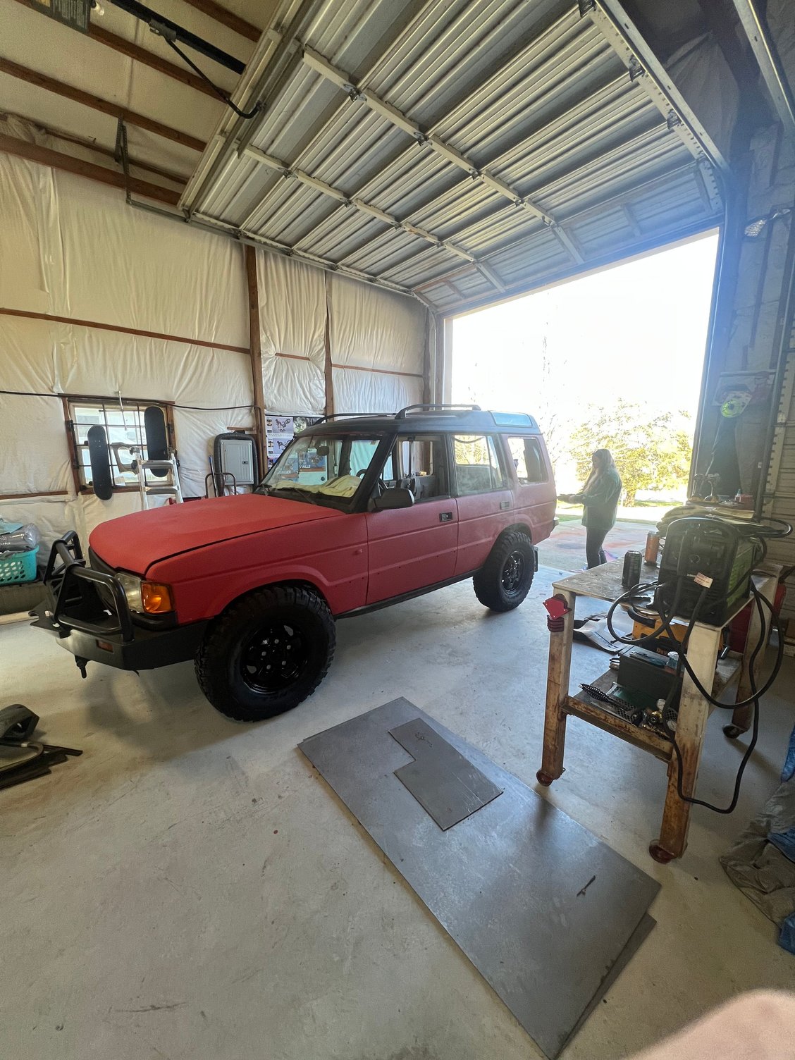

If rubbing on the inside frame, each side has its own steering limit adjusting bolt. If rubbing on the fender, more likely the body isn't straight, or the body needs lifted to accommodate the giant tires. Some folks cut the fender arch bigger for huge tires. Looks like you will need to do something, unless you never go over any bumps.

Possibly. I’m going to put a 5 inch lift with fender flares so when I get it all lifted, I will see how straight it is. Could also need an alignment really bad. It sat for 15 years. So only the Rover itself and the good lord know what she truly needs.

O she’s gonna get a 5 inch lift minimum, and fender flares. Flares will be the next modification for sure. Still deciding if I want to buy flares or make them. Still undecided. I’m gonna make an exoskeleton too. It’s going to strictly be an off-road vehicle.

double check your suspension bushings - could have bad bushing in the pan hard or bad tie rod. Good idea to have someone turning the wheel back and forth while you are under watching all the steering linkage (with the vehicle on its wheels on the ground). And dont forget to check the steering damper bushings (nothing to do with rubbing but will cause a wobble at speed).

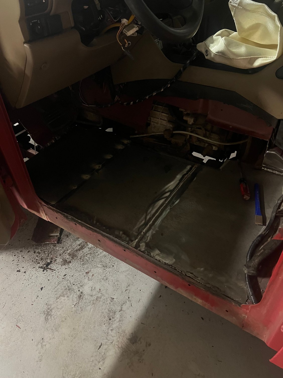

Well boys, welding to this old **** is ridiculously hated. Clean to clean is fine, but hey, they make bondo for a reason 😉
She moved Under her own power today for the first time of my ownership"]https://cimg4.ibsrv.net/gimg/landroverforums.com-vbulletin/2000x1504/img_8540_55313909e2d6739ffe9d8f352765ae4152ac04cf. jpeg[/img]
Well boys, welding to this old **** is ridiculously hard. Clean to clean is fine, but hey, they make bondo for a reason 😉 She moved Under her own power today for the first time of my ownership

idk how that happened. Thanks. I’m starting to get discouraged with how much of a pain all this welding and cutting is. This is just the drivers side too.
