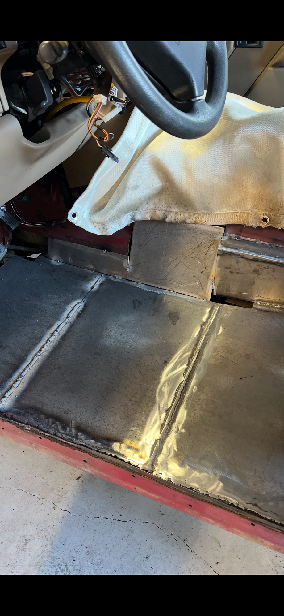

😭 starting to feel like the hours and hours of prep are leading nowhere but 1 panel each time, and those panels are a real pain because the metal is a pain to weld in. Especially to the old stuff.

You should be grinding down to bare shinny silver metal when welding to existing material. You want at least 1/4" to 1/2" along the weld edge free of contaminants to weld too. Double check/adjust your wire speed and voltage too - make sure ground clamp has good contact too. If any of these are not right = PIA and bird turds welds.

Even with proper prep work, the metal in the old rover is so thin it’s almost impossible to not blow it out. Even on my lowest voltage.
but I can get it structural and then fill and clean it later. Bondo and paint 😉
