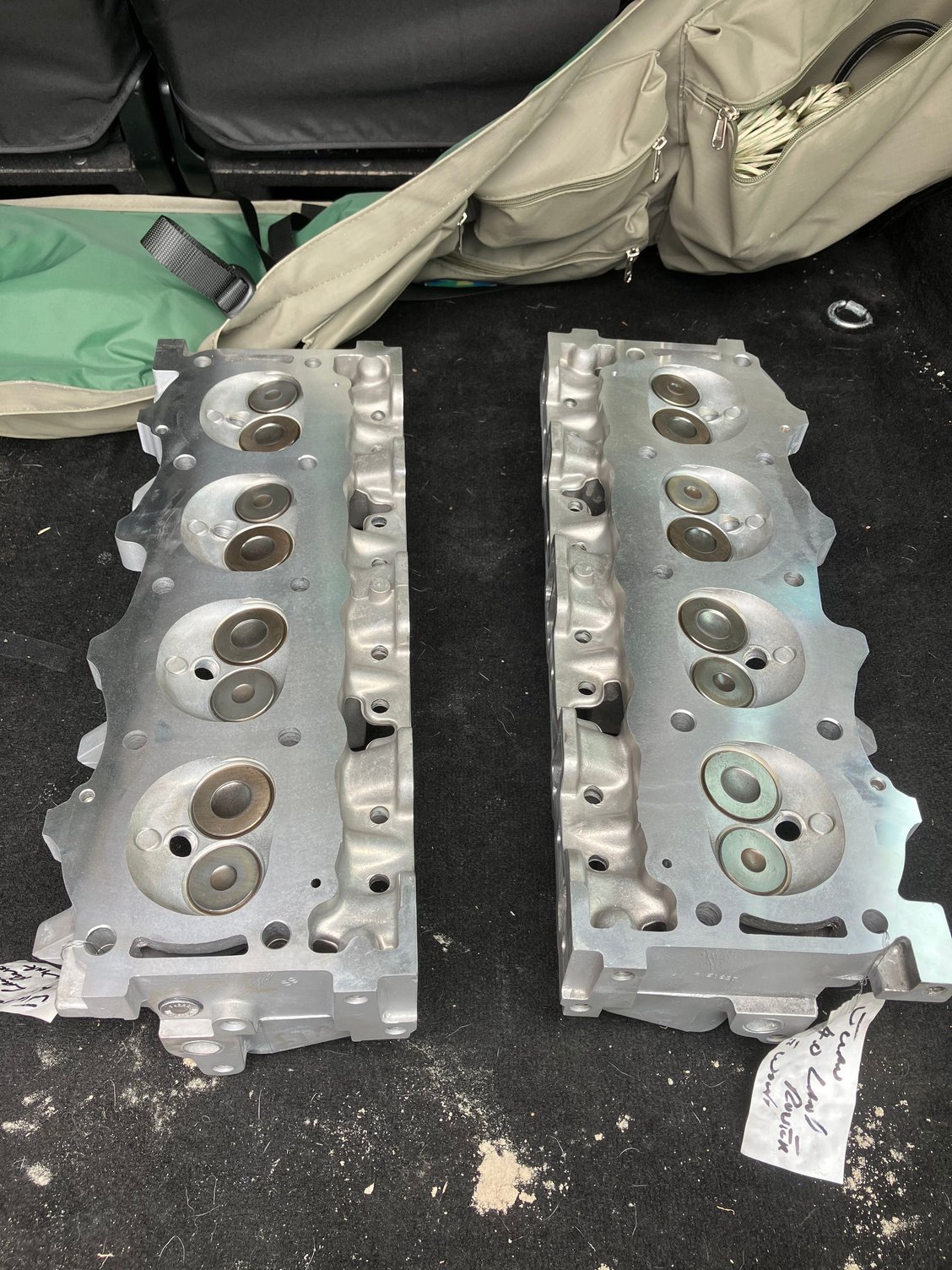

Well if it makes you feel any better, I do practice what I preach...
