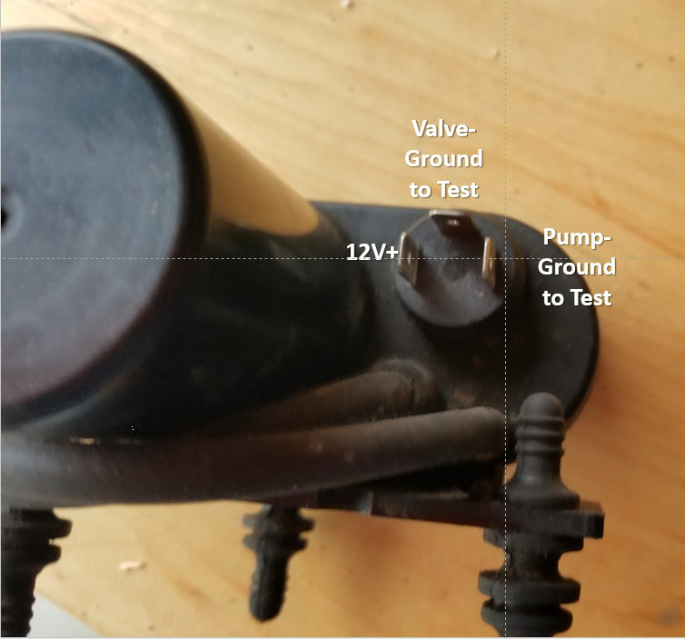

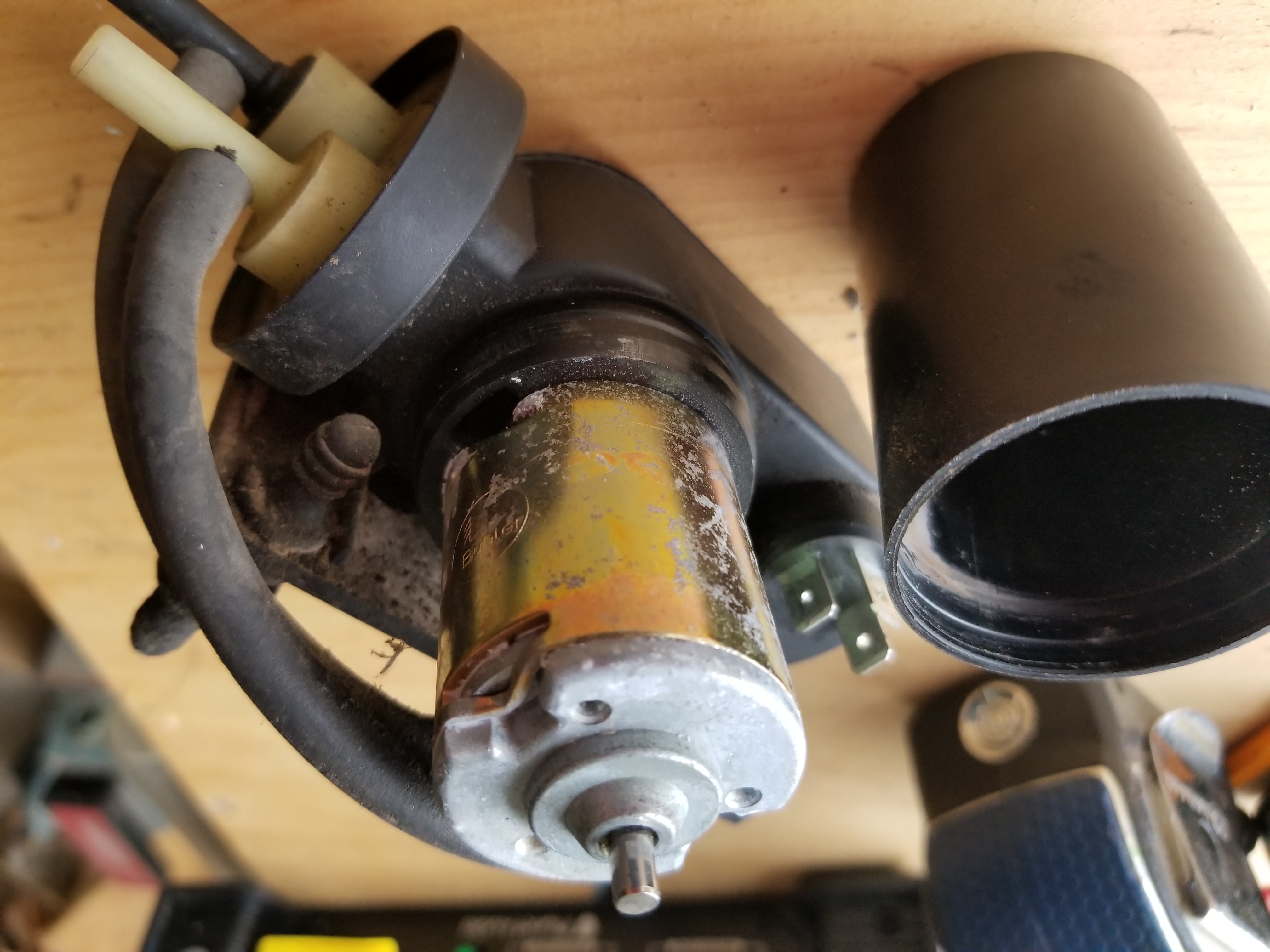

So far, I've trimmed cracked hose ends and pulled and repair the CC vacuum pump.
This was super easy and i learned that it was stuck. i got it cleaned up and repaired then reinstalled. Apparently, moisture had seized the little motor. I rotated the shaft with some pliers then ran it a bit, all is well with the pump now.

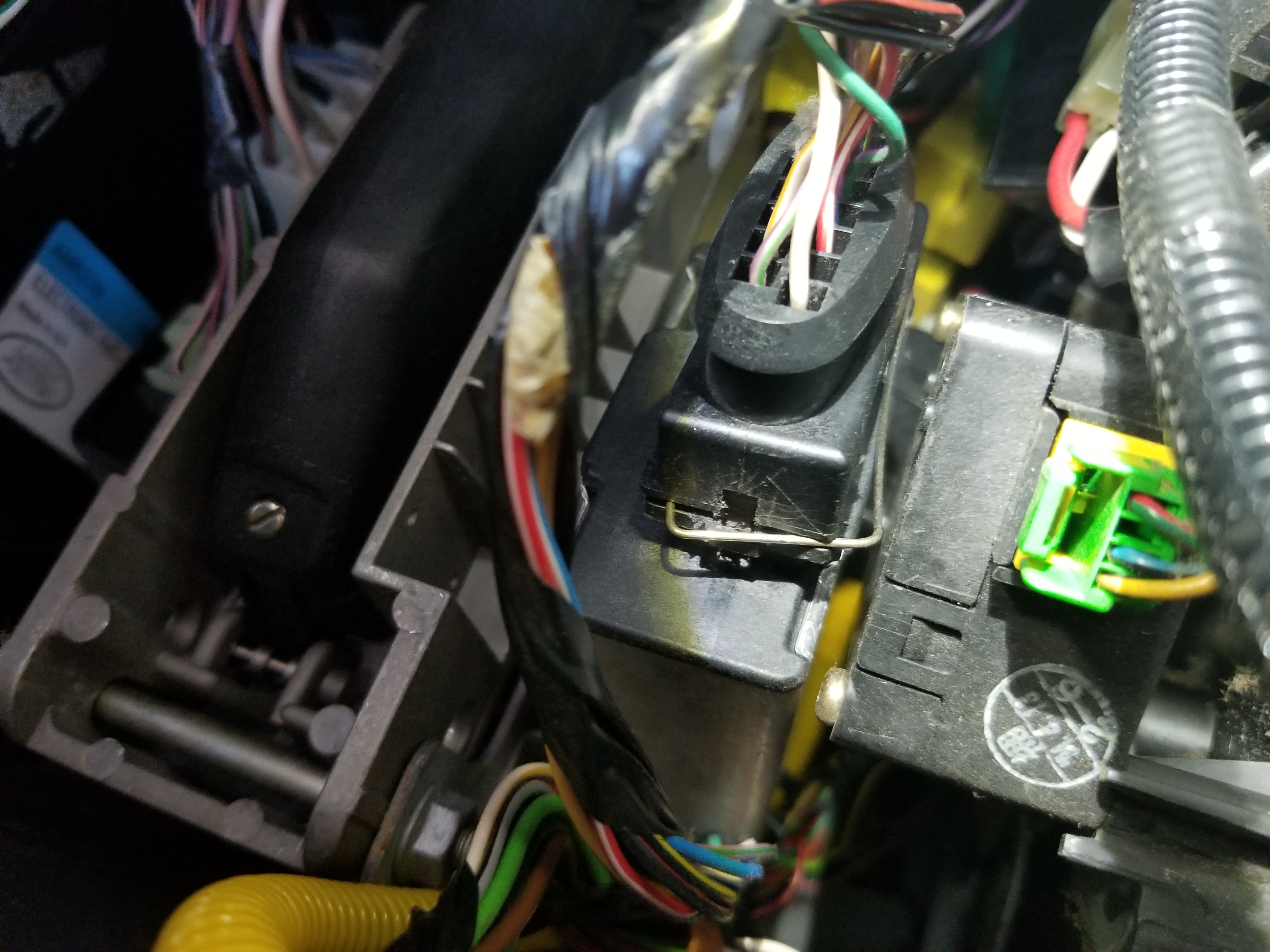

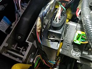

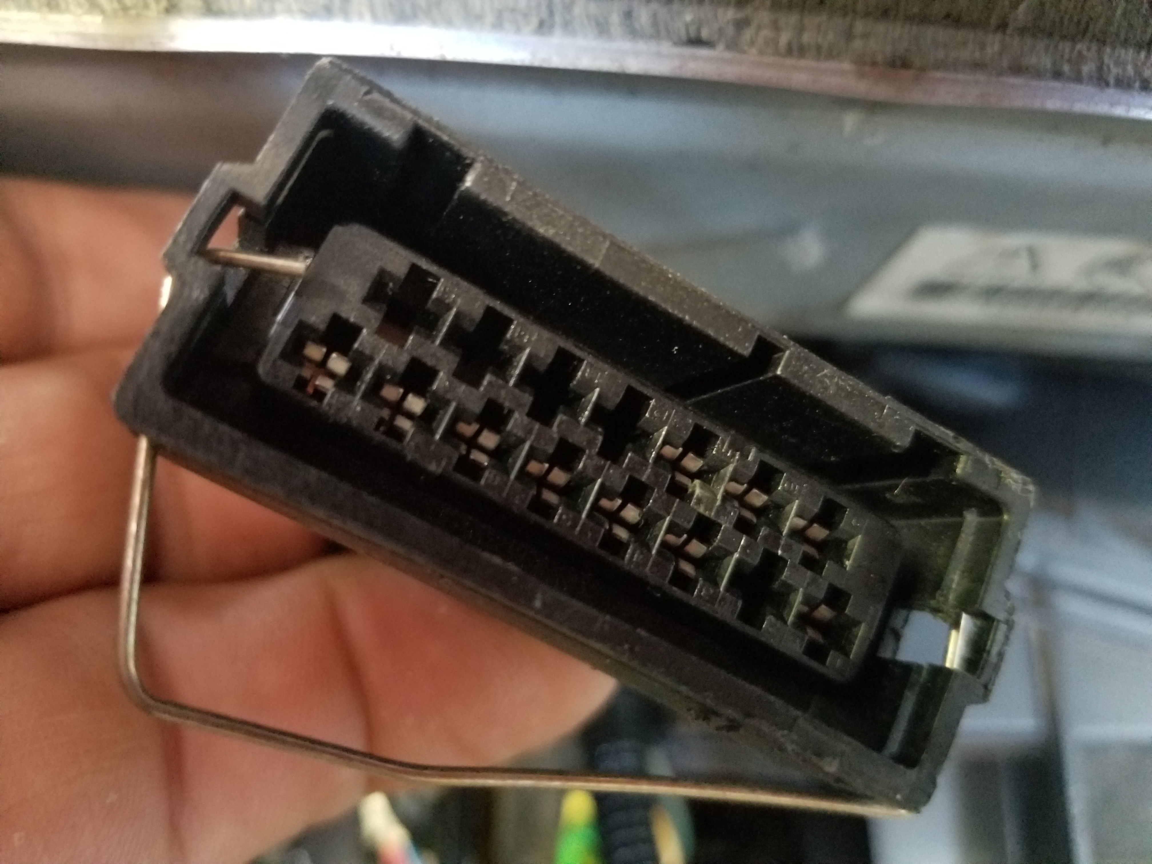

After much groaning and gnashing of teeth, i finally found how to remove the CC ECU. For those in the future, here are photos of the retaining spring that holds the ECU in place. Near the junction of the ECU and plug, on the LH side, side you will see a small bit of metal wire. pry underneath. it will pop on the side you are prying. continue pying to the LH side of the vehicle till it comes off. the spring on mine sat too far deep to pry out from the ends and had to be lifted on the side.
