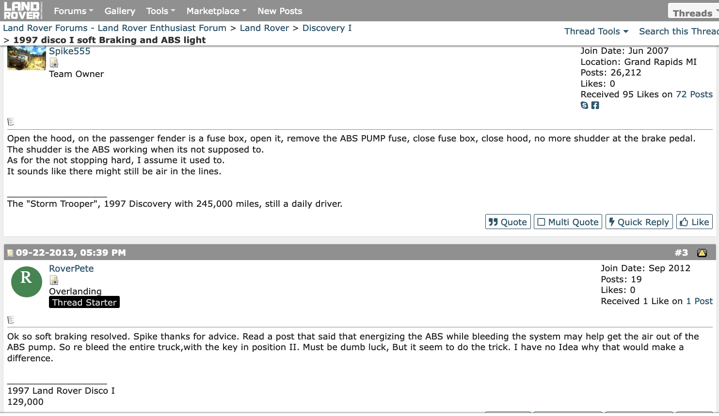

I am reading older threads where a few mentioned energizing the ABS than to start the bleeding process.

I think that's for the D2 but I could be wrong. I've never done that when bleeding mine.
Can't hurt to try but I'm fairly certain that''s a D2 thing.

Old Sep 16, 2024 | 09:14 PM
Toran's Avatar
Joined: Sep 2015
Posts: 1,125
Likes: 77
Brake bleeding screenshot
