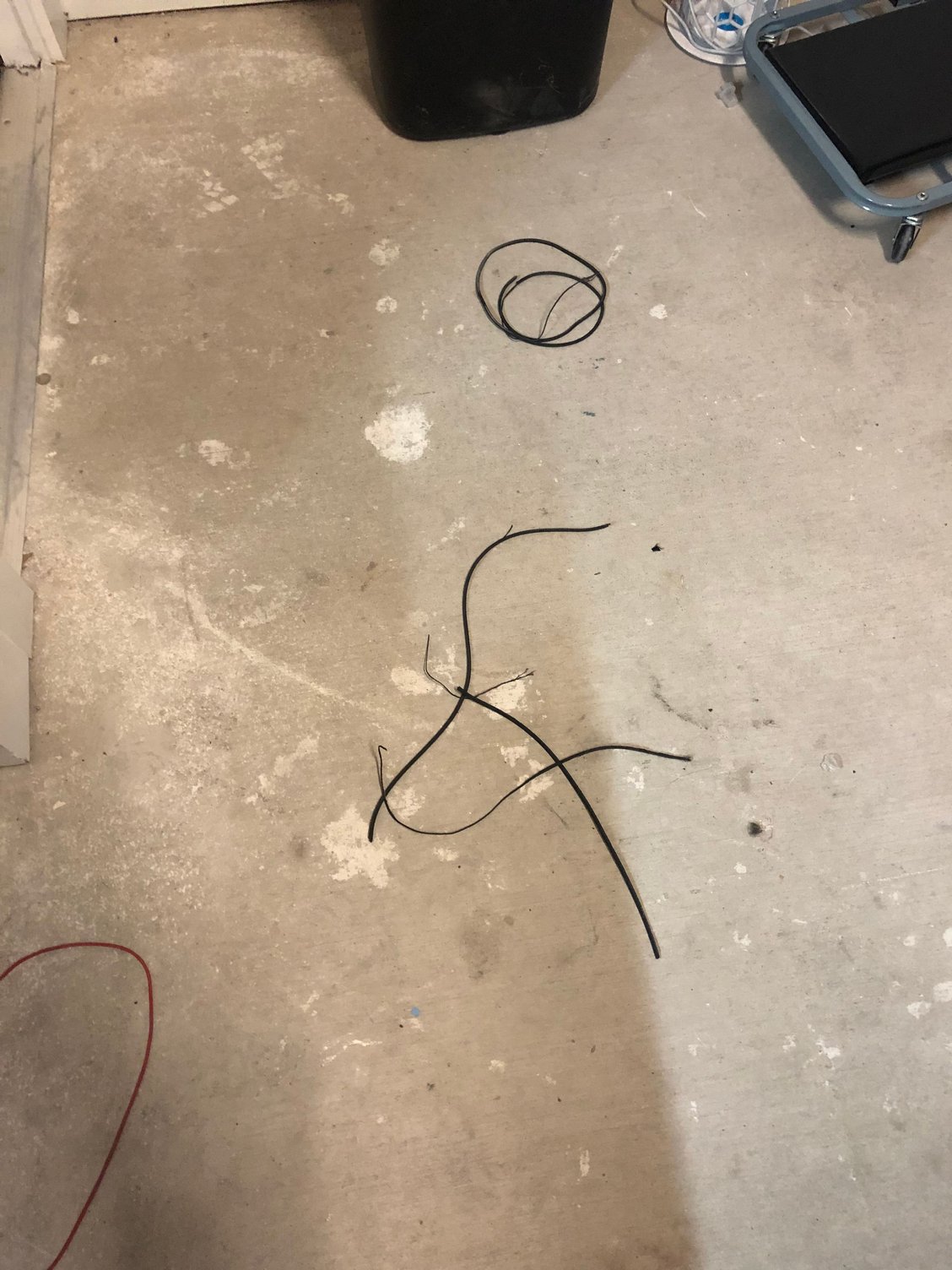

My belt is slicing on the inner side just replaced it today and can’t figure out what the deal is... I’m hoping it’s just a “bad new belt” I don’t see any obstructions to make it shred. So confused.

Literally sliced first time it ran with it on.
