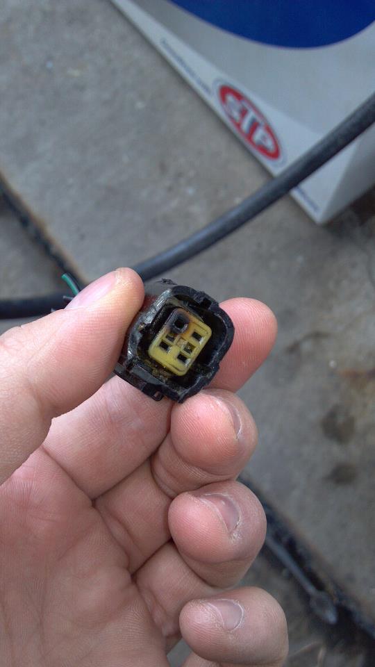

Before I owned this car the fuel pump was replaced, and from time to time the fuel would cut out and I would have to unplug the fuel pump (from cargo bay, under carpet) and plug it back in. After two times doing this I noticed the fuel pump harness had a burned end on it, so I replaced the fuel pump harness with a new one (pic of burned end below). This car has some electrical problems is what I'm getting at.
