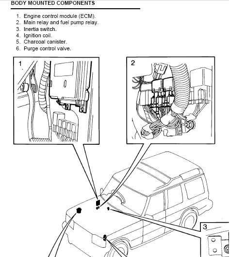

it is on the passenger side attached to the fire wall sandwiched between the washer bottle and the fire wall it is held on with two bolts and has a black plastic cover. if I can get this to work I will put a pic here
Your right the ECM is located between the washer bottle and the fire wall, but for some odd reason my ECM is under my passenger seat....

I think when they switched to obd2 they moved it to the engine bay, my 94 is under the pass dash which is better imo

yes in the engine bay is the worst place. think I will figure out how to put it in an otter box or a bag something when the washer fluid hits that aluminum it just bubbles away.
