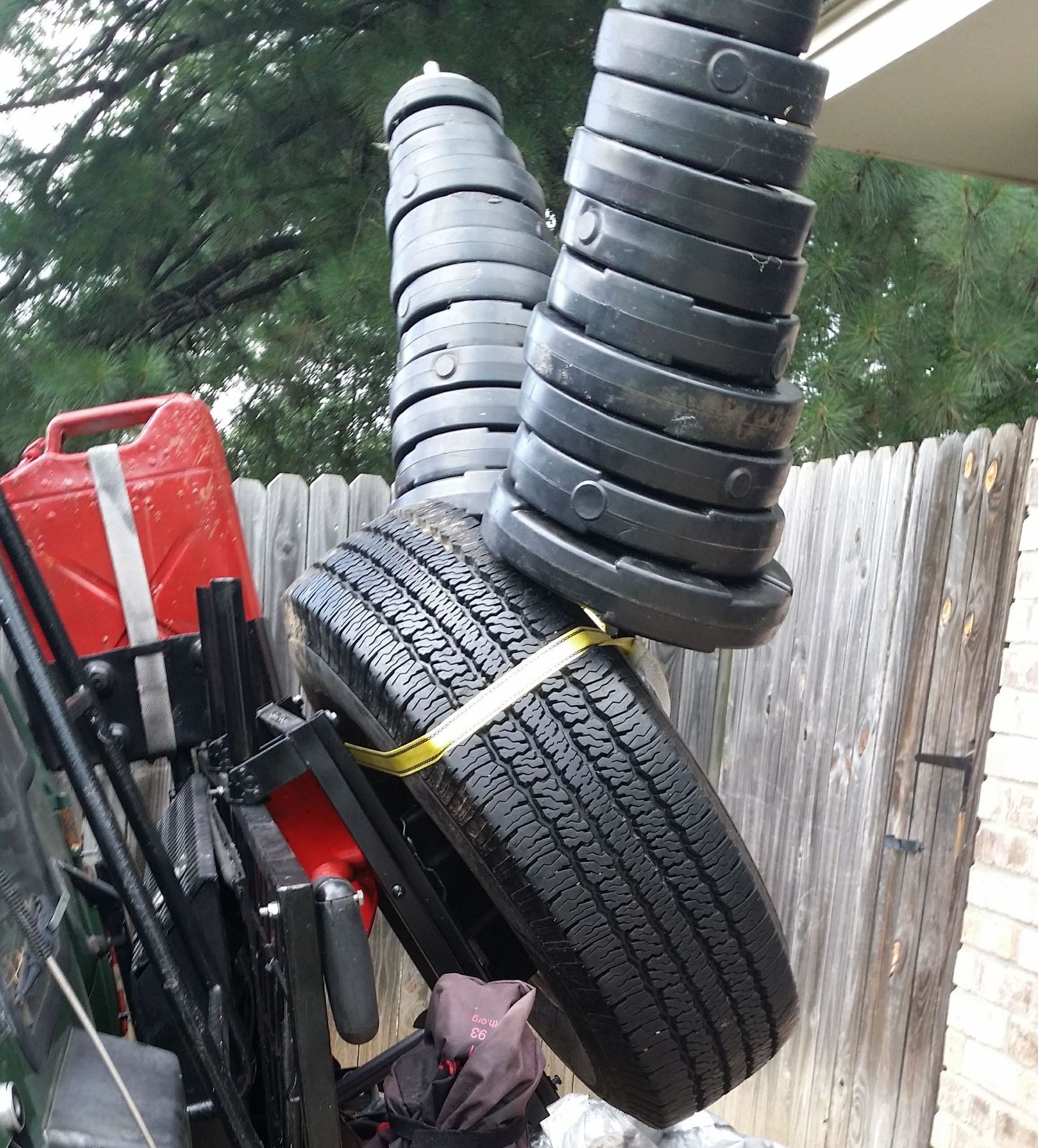

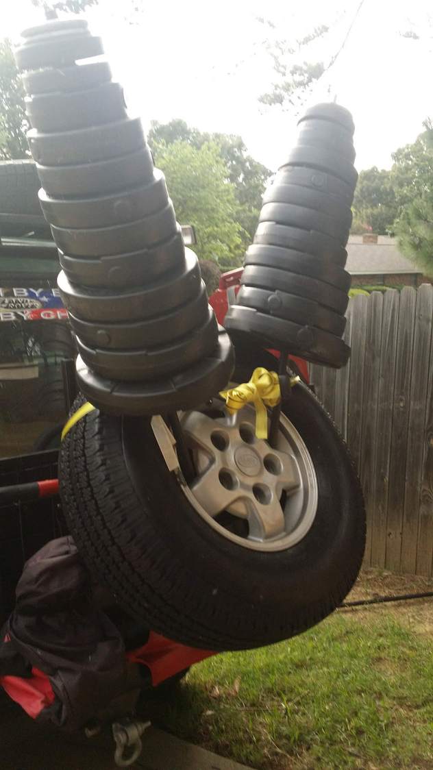

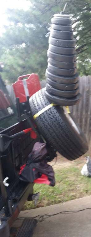

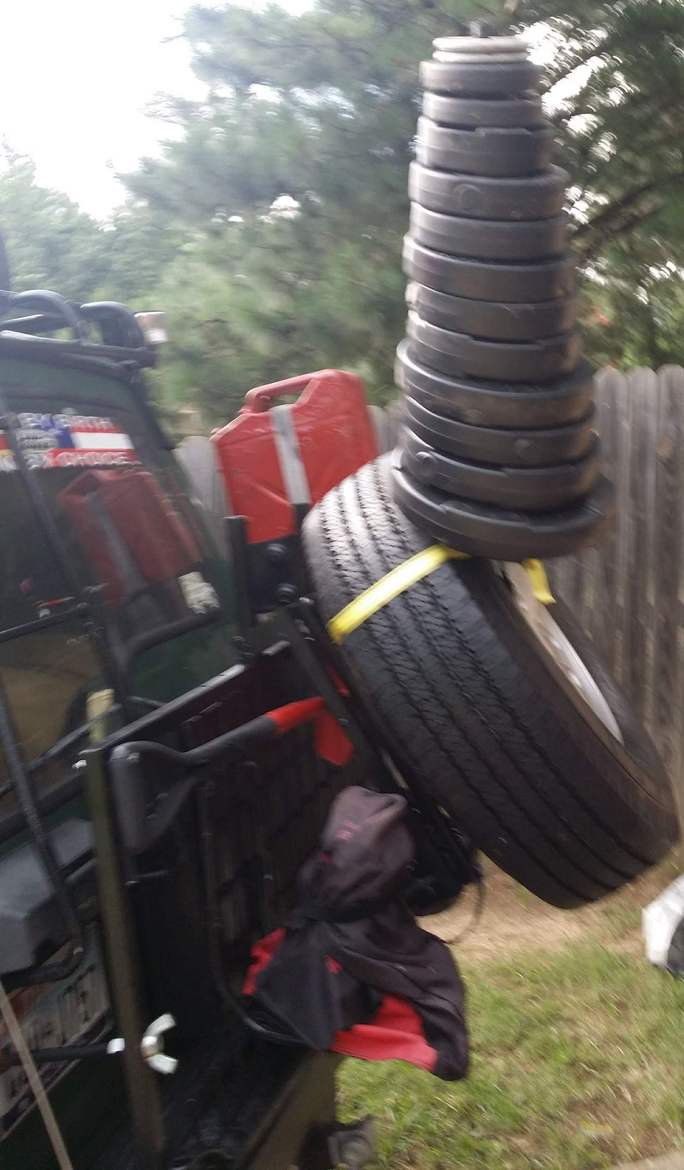

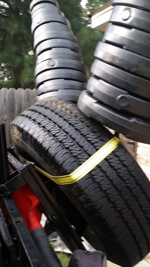

Alright, here we go. I know it would not make some of you happy if I hung my F350 dually from the tire mount but, for those who are on the fence about this perhaps this will help you make up your mind.
A couple of things I wanted to point out:
I could have gone down to US Steel bought the supplies to make this but I am far more interested in unique designs and using what I have. (This is my Lincoln.... it's sort of a family heirloom)
On with the build:
The walls of the 2-inch tubing are double sleeved. It was one of the reasons I came up with this idea.
If you actually took the time to look at the pictures in the original post you would notice there is very little of the original table saw mount that I used when I built this, the collapsible part is not present on my creation.
The double walled (Anyone guess what that means in terms of strength?) tubing was fitted with Suspended screw adaptors, and instead of using grade 8 bolts at each end I opted for allthread that connects both the adaptors end to end, through the entire tube, as well as securing it to the rear gate.
V=https://www.qa1.net/tube-adapters-7224
The OEM tire mount is secured to the main unit with 8-3/8 inch grade 8 bolts.
The gate itself is connected to the bumper and the rear of the truck with a 1/4 inch case hardened steel pole and pivot. That is just FYI and has nothing to do with this build other than how it connects to the truck.
So I inserted 1/2 steel pipe about 4 feet long into the tire and wedged into the tire mount, to use as vertical support for the weight test. The yellow rachet strap is only there to hold the pipe upright, it is not connected to anything other than the tire and the pipes.
There are 220 pounds of weights on there....the gate is not moving out and the tire mount is of course fine.
The tire that is mounted on there is 67 pounds so we are at close to three hundred pounds.
Here are some additional angles, note nothing under the rack supporting it.
Now I know that I am going to hear 300 pounds that's all? Or what about the impact on the truck?! So let's add another 210 pounds to it...now I was running out of stuff to stick on the damn things so me it is...
Now I know I'm going to hear, well your standing on the gate with your back foot and not the rack so I had one picture taken from the side so you can see all of me is on the rack. It is difficult standing on top of the tire so I was not up there for very long but. I was up there several times..again no movement.
So there are around 500+ pounds on the rack..The weights have been there for several hours no failure...imagine that...
Tex

all of your stress testing was done in a lower mounted position then the pics you posted originally. That lower mounted position has way more support - simply by the different angles used. - Up top it is totally cantilevered.
Do the same with it mounted up top.
