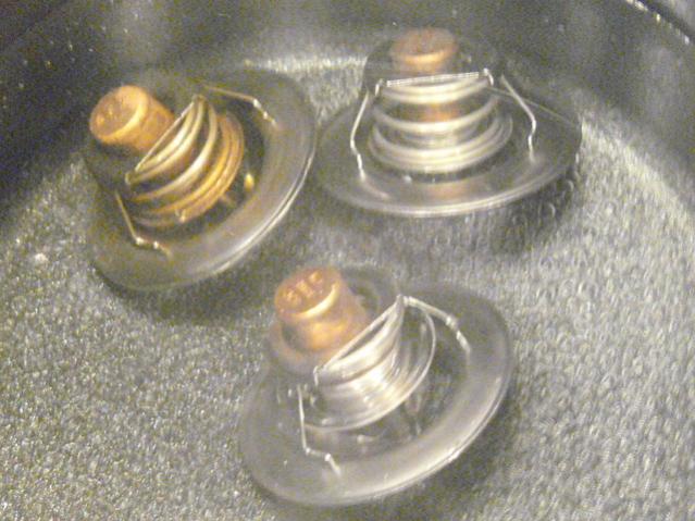

And you can "test boil" the new stat before installing. SWMBO will assign the cookware for the test.

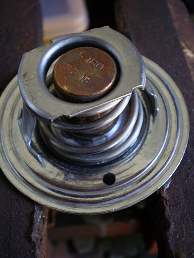

hint - buy a couple of gaskets, to have on hand should you need to return to the scene of the crime. Also, stat should come with a "jiggle" device which rattles when you shake it. That lets gas bubbles pass by when stat is closed. Orient it to the 12:00 position in the mounting location. If no jiggle device you can drill a 1/8 inch hole in the flange.
