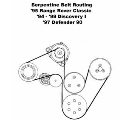

Before you replace the alternator double check the Serpentine belt is routed correctly and in good shape (no cracks, etc.). Also check the belt tensioner is putting enough pressure on the belt/pulleys.
13.91v @ 1500rpm with accessories on is not crazy low. If you want to be 100% sure pull the alt and run it down to NAPA. They can bench test it for free. Good Luck
