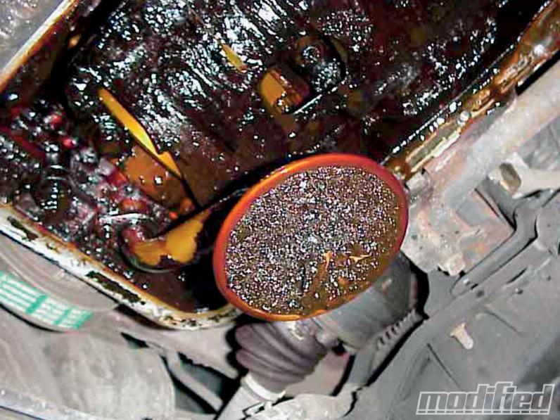

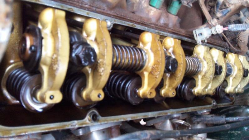

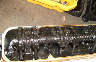

Pages attached from RAVE. Pix of what you may find, if really gunky then the bottom end will look the same, like the oil pickup.

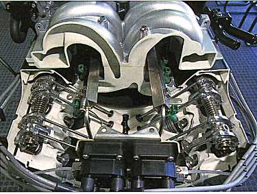

Also pix of cut away of valve train on a D2, this is the rare "low rider" chrome version, with rapid swap coil wire configuration (once you put a firewall behind it things change)....
