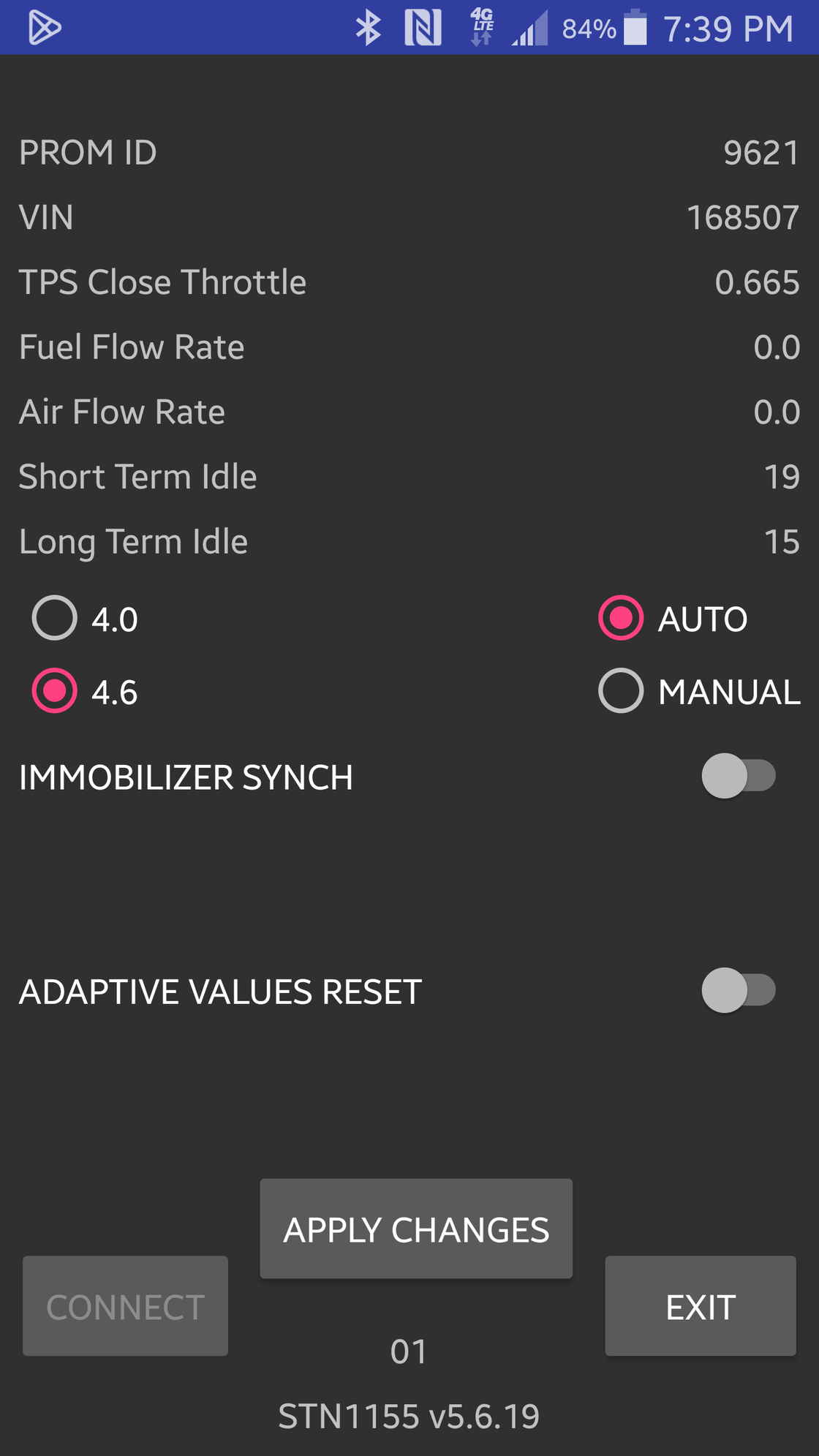

If the pink dots on the screen grab are accurate, you have it backwards. If you have a D1, it is a 4.0 (unless someone did something big) and you have described using a clutch so it is a manual, not auto.
I have no idea if this will matter or not but it is an obvious 'error'.

Why didn't I notice that it was reading 4.6 auto..I blame the summer heat lol. Is the Torque app the one that is by Ian Hawkins on play store? Just want to make sure I get the right one as there seemed to be a few others also.

Default GEMS app Retest update/info
So I went out and did another test with the GEMS app, to double check the engine/transmission selection, and even if I select the 4.0 and manual the moment it connects it changes to 4.6 and automatic. Am not really sure as to why it is doing this, as I couldn't find any mentions of this type of situation via searches. I don't believe it's a 4.6 as the stickers and the plenum cover all say 4.0 and I know it's not a automatic, and when I looked to see if maybe a previous owner could have swapped the ECU, as they did a lot of really questionable stuff to the rig. I found that wasn't really a possibility, but going to pop the ECU out later and make sure it's the correct part. Beyond the app engine/transmission confusion it is possible that I didn't rotate the TPS correctly when lining up the screw holes, as when I did I just lined it up, and slightly rotated in the direction the spring rotates to get the holes to line up. Later once it cools down a little bit I can go attempt to realign it the way you described John, and will let you all know the results, and thank you once again for all the help and information so far. Am hoping that it will be that I put it on incorrectly, and just a bonehead should have checked exactly how to install one moment.

Thanks for the info on the app. So I went out and took the TPS ofd to see if I put it on qrong, but it was on the right way like you described. I then thought to check the IACV, and it was rather dirty with carbon. So I took some 90% iso and cleaned it up, and put it back on. After everything was back together I started it and normal idle. Gonna test again tomorrow and make sure, but I didnt reset the value. So I will also do that tomorrow and let post a update. GEMS app still saying 4.9 auto so not sure what is up there.
Readings from after cleaning IACV and re-install of IACV and TPS, but no reset of adaptive.
