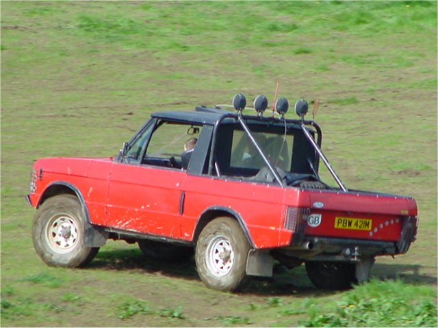

Are you making it a bob tail as well. I have done 2 range rovers, 2 doors and a 200 tdi discovery 3 door. That one was done as a full tray back with. the picture below is of one of the range rovers, will try and see if i can find a picture of the disco
Yea it's getting bobbed not exactly sure how much I am going to take off yet.
