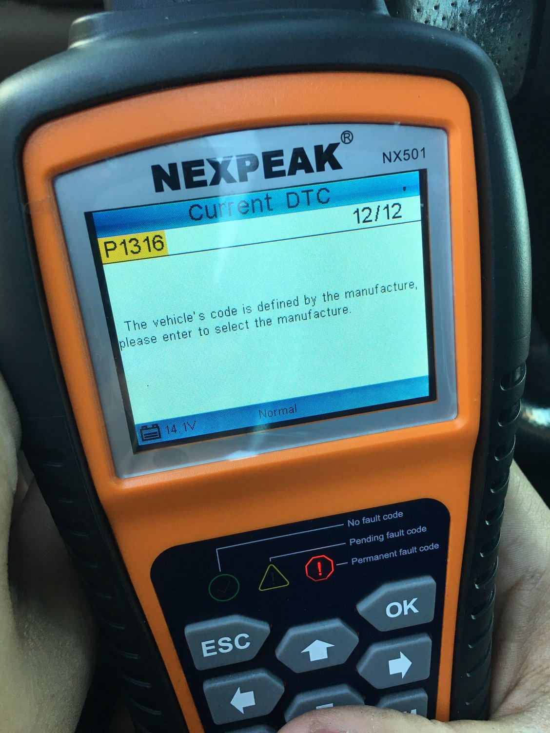

this reader my son uses on his Subaru works on my D1
