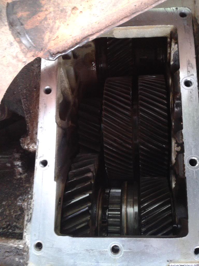

Remove the large cover on the bottom, I resealed mine with right stuff rtv in a can seems good so far
Hare to say you might have burned up the gears and bearings
Here is mine inside

Look for gears discolored /blued, cupped teeth , teeth worn to a point, chipped /broken
My pic is normal

Originally Posted by TOM R
Look for gears discolored /blued, cupped teeth , teeth worn to a point, chipped /broken My pic is normal
I was terrified I burned them up until I pulled the inspection cover. I saw no visible damage nor found any large chips or chunks of metal. Flushed and filled the t case a bit earlier. Used Lucas 85w-140 and also greased my u joints since I was freezing and under the truck anyway. Long story short...
SHE LIVESSSSS!!!!!!! No odd noises, no whine, clank, nothing. Drives like a dream. I seriously feel like I win the lotto that I didn't grenade the case or trans. As I said I the OP it just so happened to decide to give out about 25 ft from my parking spot.
Thanks again Guys. You helped me think when I was in panic mode. The wife can now have her tiny car back.

wow I guessed right again lol, glad it worked out for you keep an eye on that fluid, there may be damage unseen like to bearings etc. so if you start having trouble again it may warrant another transfer case
