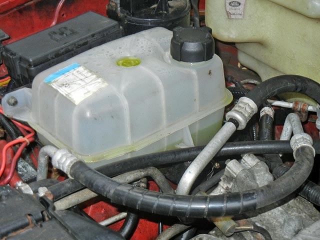

First off... serp belt is fine and routed correct. Tested for exhaust gas in the collant via test kit from AutoZone. Liquid stayed BLUE. Neg results (see picture). Not convinced the test is 100%... but that may be me. It did turn yellow from my breath when I tested the kit. The guy at AZ suggested I order a new temp sensor. Don't agree with that one. The aux fans come on by themselves when the engine gets hot as they are supposed to via readings from the temp sensor. Culpret is the air not delayed fans. For all the years we have had the truck the fans NEVER came on by themsleves except whern the AC is switched on.

Maybe the rad is clogged down below and I am not getting enough flow on hot days? But if clogged below how is the collant gettign to/from the motor? Has to be the source of the air that is the gremlin. The upper hose contains collant and if squeezed I can see the level in the expa tank go up and down. I had expected the upper hose to be more firm. It is soft? The T-stat is out... maybe un obstructed collant flow (no Tstat) would keep the hose pressue down?

See pictures below on all this. Also made a video where you can see the air burping into the exp tank.... see the coolant moving in the RAD... HEAR the air after the truck is turned off... sounds like boiling inside the motor. Hope the link works for all.

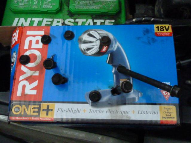

Pix of what you may see with water pump, left side is a leaky one that was wobbling the pulley. El cardboard bolt arranger - several different lengths. Brown coating is good old leak stop - it coats every surface inside the cooling system, and the rest of the bottle goes to the low spot - the bottom rows of fins in the radiator. Just like stirring up mud in a glass, most of it will eventaully settle out.
