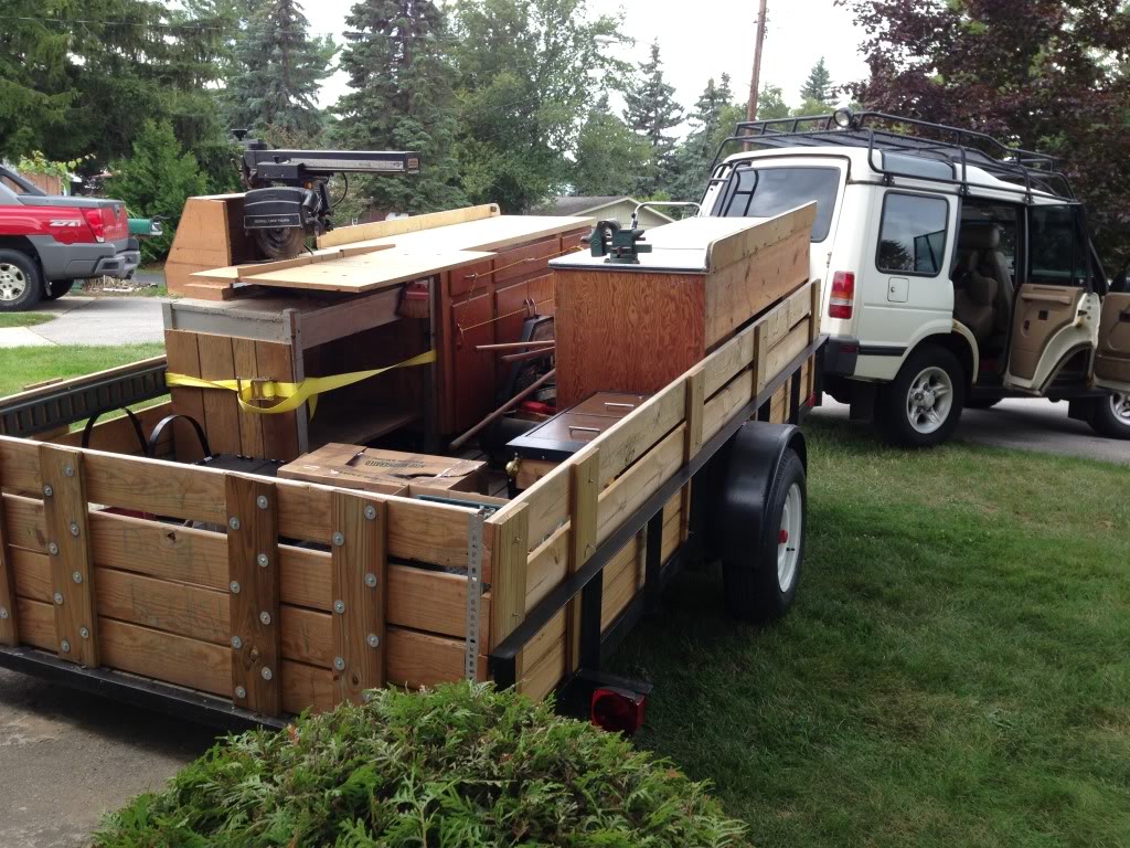

I recently pulled a 3,000lb utility trailer back from my grand parents, 170 miles home, 90+ temps, climbing steep hills in 3rd gear at 65mph for a mile at a time and my engine never got above 200*F.
Work benches, full of tools, truck was full, me and my dad in the front.
