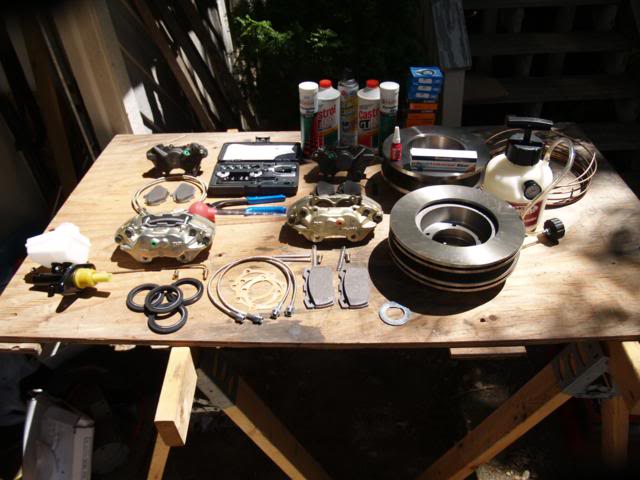

NAS D90 front rotors are at the front in this photo.

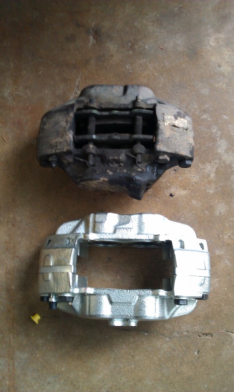

D1 caliper top, larger D90 caliper bottom.
