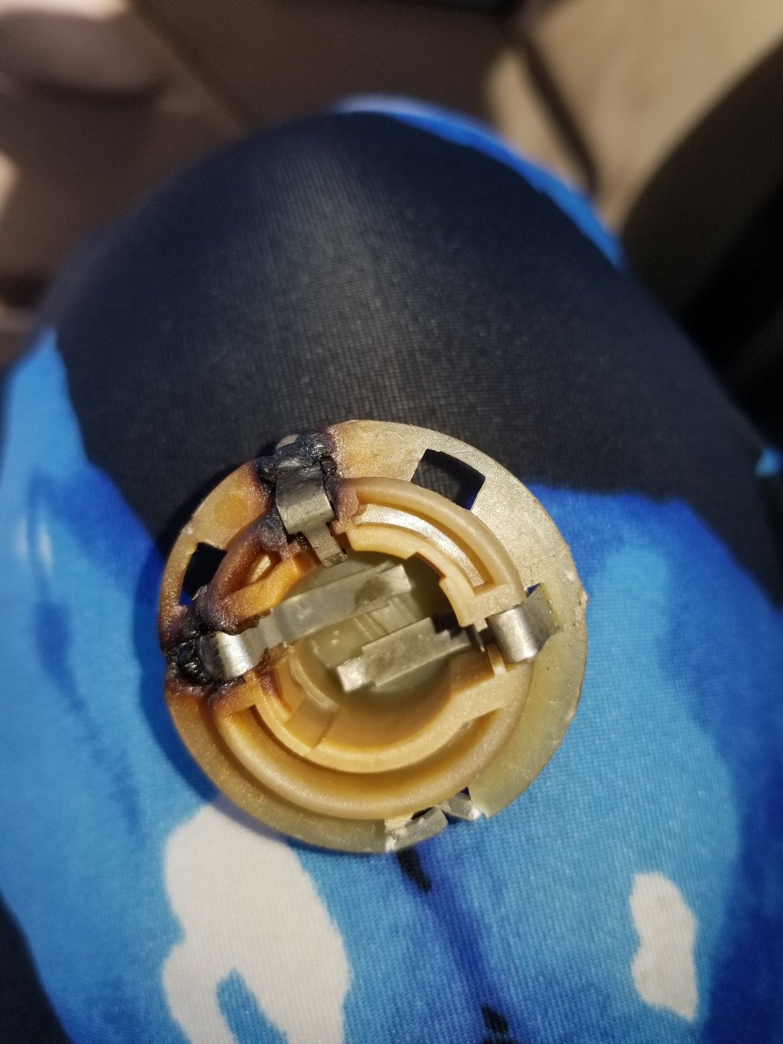

Check your rear lamp bulb sockets, brake lamp being lit is part of that circuit. I've had the socket "melt" enough to open the circuit. Put a resettable breaker in the one you've upped the rating on and trace through the circuit... Russ
thanks so much. That's exactly what happened. My top socket melted. I have a new taillight assembly coming so hopefully that will solve the problem.

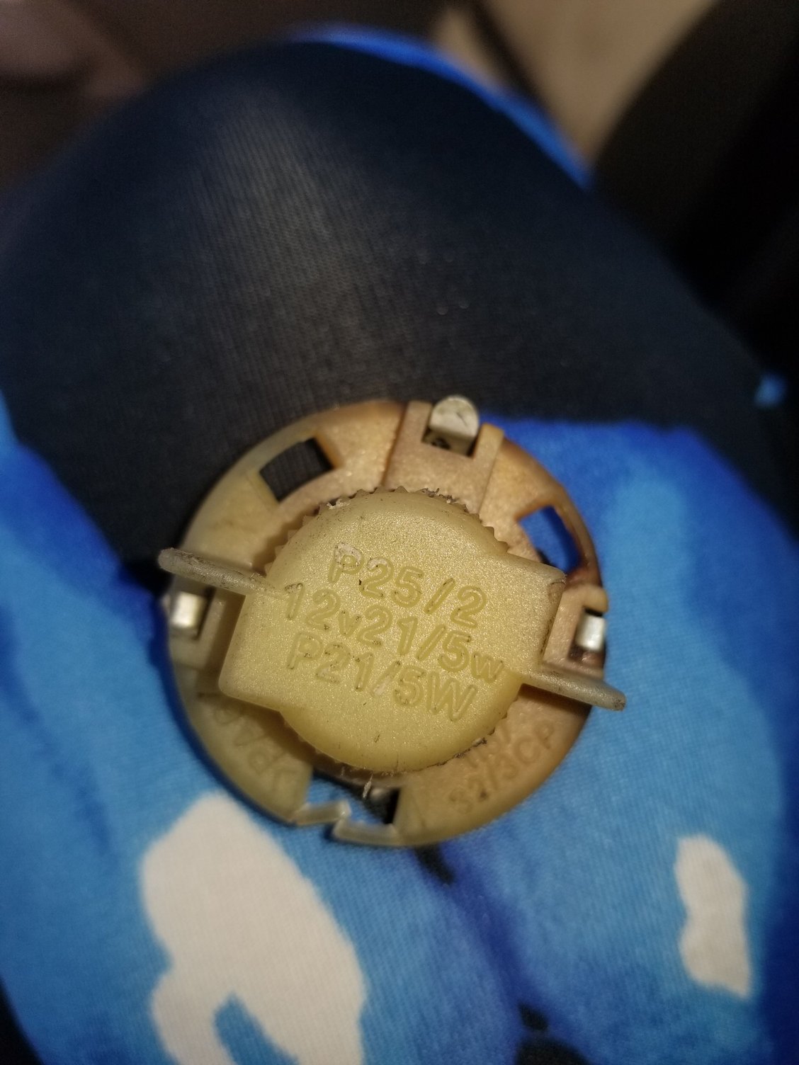

Here's what the socket looked like when I pulled it out
I tried replacing the top socket but the casing that it goes into is so bent and deformed that I can't fit another socket in there.

Had the same issue with my brake lights, the socket you pictured is definitely a problem. I ended up replacing the whole assembly and the brake light socket was missing. Seems they are hard to find right now and I pretty much cut mine and rebuilt it to make it work. The shifter needs to see the brakes applied before it will shift out of park. I got stuck at work once with the same problem, I ra a jumper wire from the rear window defroster to the 3rd brake light and turned on the defroster to activate the brake circuit and it shifted out of park so I could get home. I replaced the brake light switch.
There are 2 different switches depending on if you have a manual or auto transmission. I had mine out when I went to O'Rieleys auto parts and they had them reversed in their book. Saved me an extra trip to get the right one.
The wires for the back end go through the headliner on the drivers side, not under the carpet.
