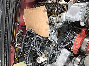

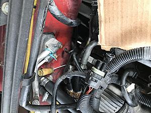

Besides a brain, of course. I'm changing the head gasket among other things on my 95. I'm trying to get the injector harness out of the way. I have it off the drivers side, but can't seem to get it out of the way on the passenger. Rave says to move it from behind the fuel rail and off to the side. But it is connected front and back so I can't move it much further than it already is. But I've seen other tutorials with the entire intake manifold area looking clear of the harness. Am I missing something? I don't see any other plugs I missed anywhere.

Pull the nuts off of the injector rail mounts - they also hold the harness clamps. Russ
