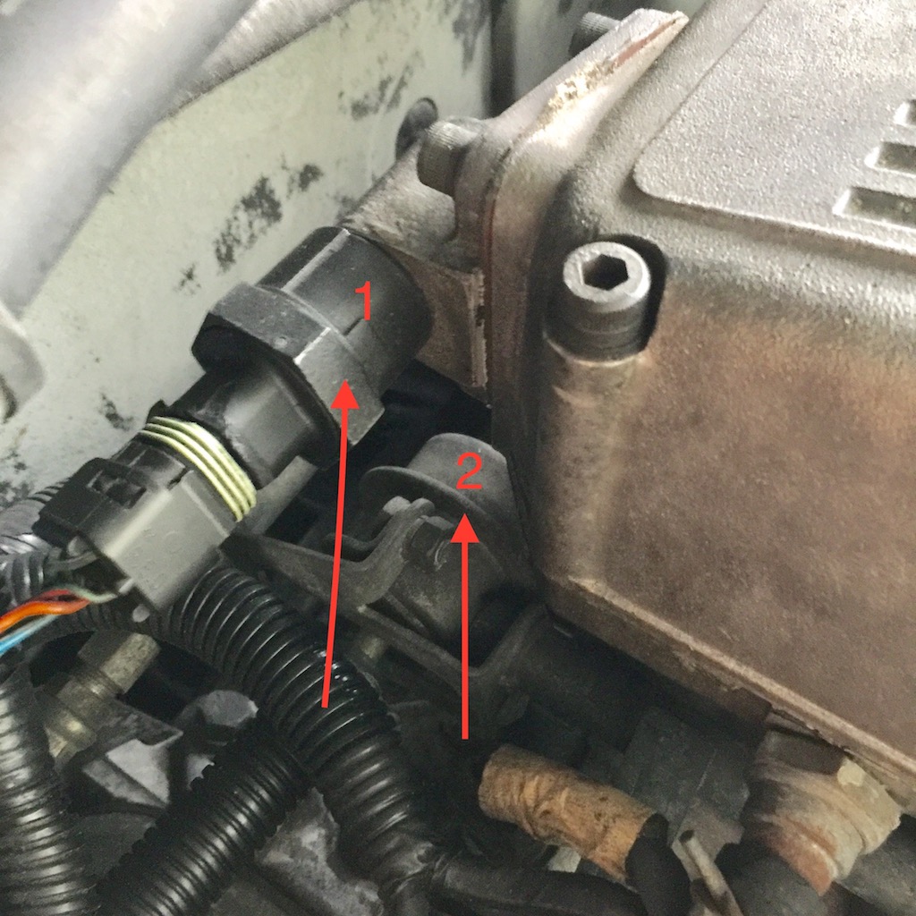

Hi everyone,
I need help identifying these mystery parts (pics attached...part numbers would also be huge help) so I can order and have them shipped here to Borneo. Engine is on a 93 Disco and is a V8 3.5L EFI.
Thanks!

1. Idle air control valve
2. fuel pressure regulator
3. looks like the fuel rail temp sensor

1. Idle Air Control valve (IACV, AKA: Stepper Motor) Part #: ERR6660
2. Fuel Pressure Regulator Part #: ETC8494

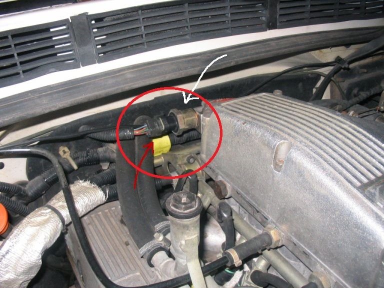

3. Fuel Temperature Sensor Part #: ETC6661
Just wanted to point out that your IACV( #1) has the female plug end cut off. The connector from the truck will never lock in place with the index missing. If you look in the first pic, you should not be able to see the green weather seal exposed. The 2nd pic is how the IACV and connector should look. Pic #4 is where the sensor lives. When you remove and replace this sensor be sure to clean inside where it seats first.
