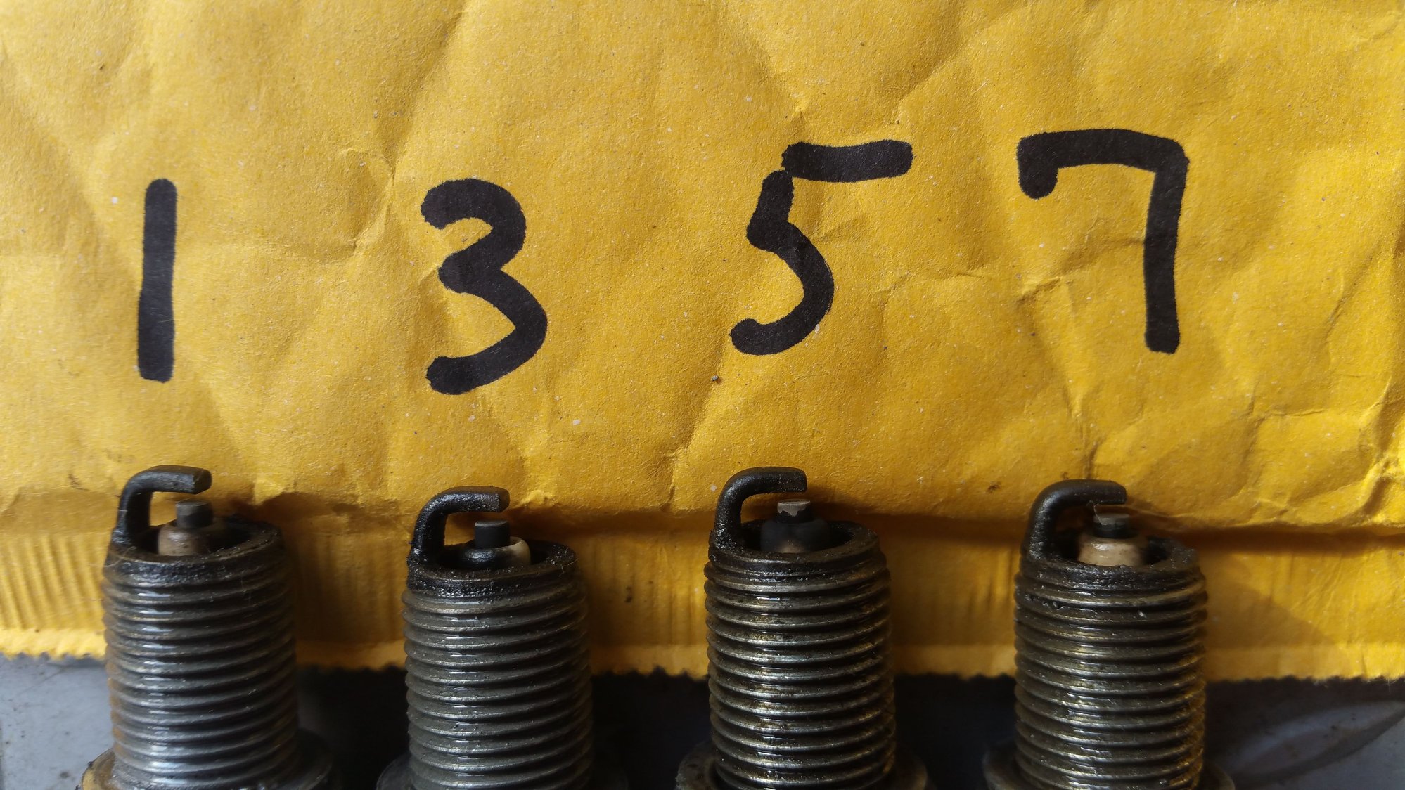

Hello Good People,
Today I was able to replace the spark plugs, and here is my findings.
Plug #6 looks the worse.
What should I know and be doing about this?

The plugs removed in the image are the standard Copper Champions.
Though it has been 2yrs with these spark plugs it has only been 3300 miles since their install.
Spark plugs on the 2-4-6-8 side smelled a bit on the gassy side.

I have zero experience with discos but that would lead me to believe you have a weak spark... see if all of those get their spark from the same coil pack. I'd probably just replace all coils... and running rich/ putting unburned fuel through the system like you have will eat cats... and cause your o2 sensors to notice lol.
Also... intake/exhaust leaks on that bank?.. look for them... you can over fuel from that.

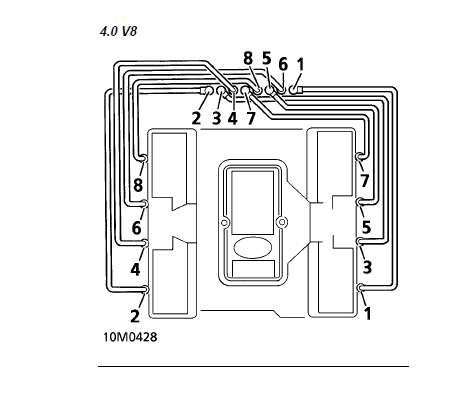

I believe there's 2 separate coil packs. 2,3, 4 and 7 work off one and 8,5,6 and 1 the other. I had flipped flopped mine at one time due to loosing spark but later to find it was the ECU shutting #7 plug ( long time ago) because I had a bad VSS.

D1 GEMS = 4 Coil Packs with 2 per Coil & D2 Bosch = 2 Coil Packs with 4 per Coil.

D1 GEMS use the same coil packs as a 96 Mitsubishi Eclipse 2.0L 4 cylinder & D2's use the same coil Pack as a 95 KIA Sportage 2.0L SOHC 4 cylinder.

when your Disco would not start back in June, would it turn over or it did nothing as if the starter was not there? A bad coil pack would not keep it from turning over. If all the plugs look like what you attached, I would think something else is the problem, IMO. When it runs, is it misfiring, sluggish? If it starts with that switch bypass, yeah, that would eliminate the starter.

She started up and was good to go with no error codes. It ran and felt solid. Solid up till June 2020. When to the car and it would not start, just that click. The truck's battery is always put on a trickle charger when parked at home, so battery is always topped off - Optima YellowTop. I ordered a starter cause I thought that was the issue. The old starter once apart showed signs of needing new brushes, though I never had any hard start issues. With a new starter in place I got the same click. So now I am in a jam and I need the truck for work so I connected a momentary switch to the starter and she fires up every time! But when she runs it is now rough, there is a misfire with P1316 error code only. I doesn’t have the power it had before it would not start. At times there is slight fuel smell. Pressure on the fuel rail is between 30 to 31 psi. Thought it could be a sticky injector so put in some Lucas Injector Cleaner, along with some Techron injector cleaner.
A few days ago I replaced the spark plugs and that was a step in the right direction as it drives better. This time I notices a little white smoke from the exhaust. No coolant leak.
