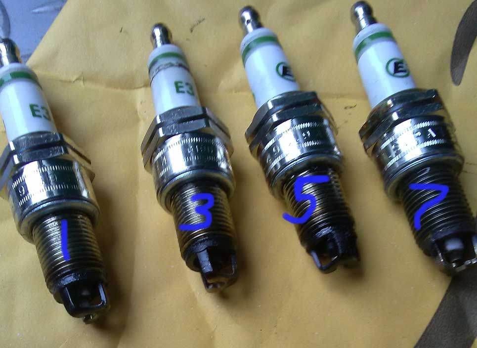

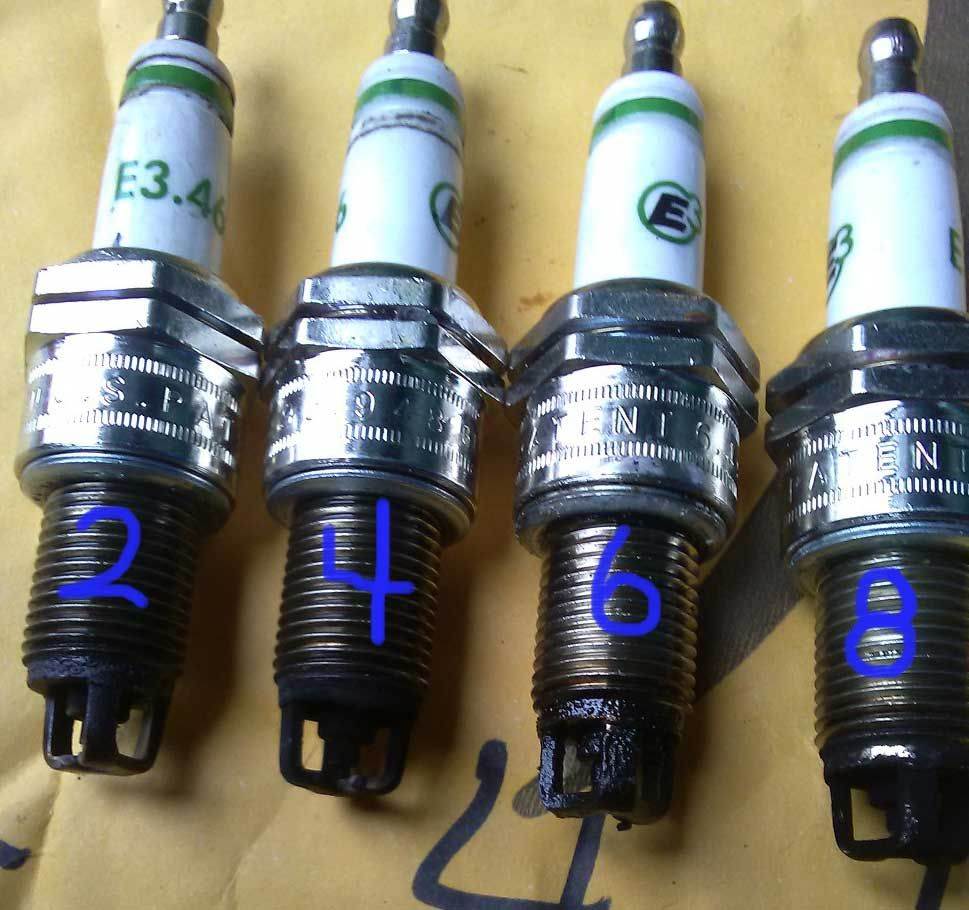

So after my last post I noticed I had several leaks in the exhaust. Patched a few which caused holes to appear somewhere else along the exhaust. Last week I installed an entirely new exhaust system from the manifolds all the way the end of the truck, everything! This includes installing 4 new O2 sensors. I was surprised the power wasn't there and I was getting the 1316 code again. I removed the brand new spark plugs after 2 months of usage and they looked terrible.
I switched them out for a new set of NGK 7131 plugs.
Could it be that it was a bad exhaust system / bad O2 sensors clogging the plugs?

#6 in both instances looks like oil fouling. I'd be doing a compression test on that one at the very least.
