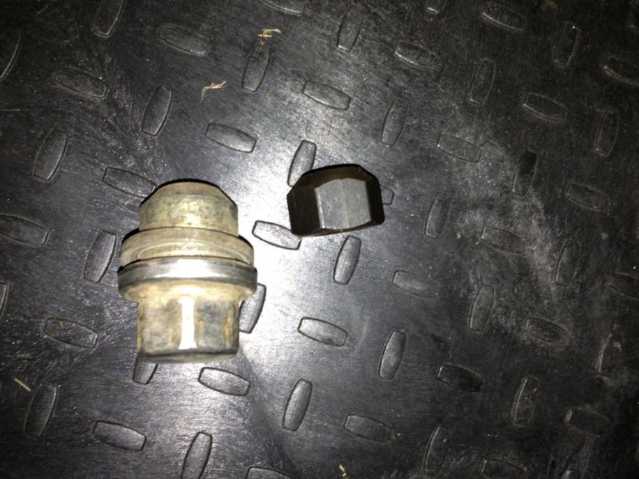

The alloy lugs nuts can be used on steel wheels, since they have the taper, but I think the steel wheel lugs aren't the right shape for the alloys. The alloy lugs have a big shoulder and washer. They might pull right through if used on an alloy. Not sure about that though.

Once you see the alloys you will understand.
You need to buy used, look for a set of Range Rover Classic lug nuts, they are solid steel and not capped like the DI lug nuts.
Thats the route I went, they were tarnished and I had to clean them up, but they cleaned up nice and work great.
$35 shipped from a forum member in the classifieds.

Ok so the alloy wheels seat on the cone and the flat, makes sense then. Thanks all!
