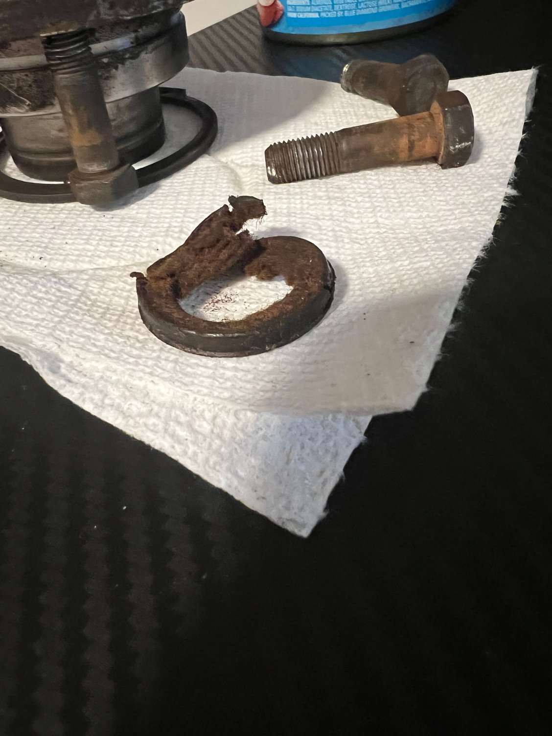

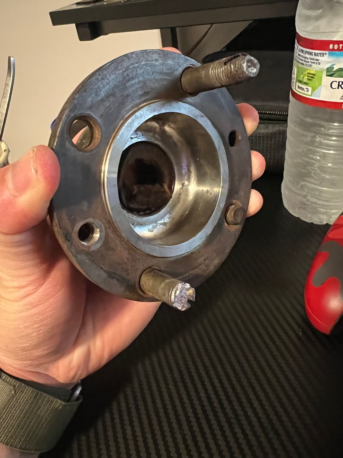

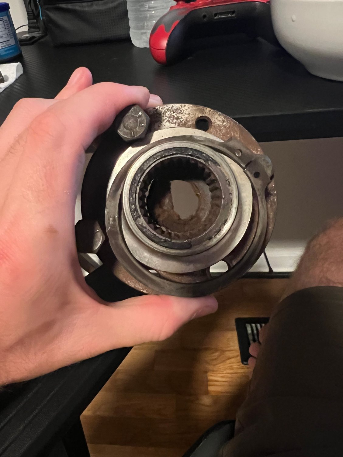

would any of you know a part number for this gasket? Had to take the driveshaft out to service the parking brake cable, and when I pulled it out this gasket for sure needs replaced. Seem to be a lack of schematics online or in the manual for it. Didn’t realize until after it was out I didn’t need to take it out but glad I did as this gasket is a goner.
@whiskeynipple0088 @JohnZo
here’s the side that faces the transmission:

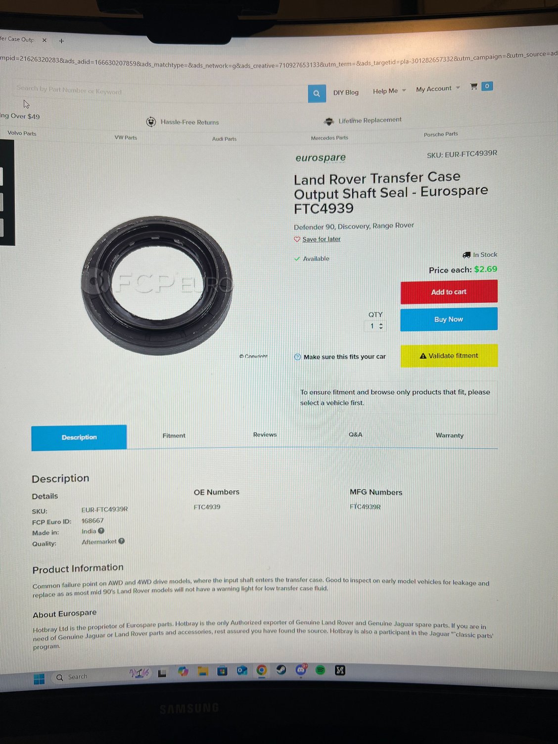

im thinking it’s this maybe?

Maybe FRC7043? Roverparts.com has parts catalogs for Disco 1. Scroll down to the bottom of their webpage and look under Resources Center, Land Rover Discovery I 1994 - '99 Parts Catalog. It shows on page 11 (Transfer Case). Those catalog pages have really helped me, even though some part numbers have been superseded by now. There are also catalogs for Series and Range Rover Classic. Rovers North also shows parts diagrams on their site. A picture is worth many words....
The Product Information for the part you show seems to say it is for the Input, even though the title says Output. Seems to be a minor mystery???

It’s the output shaft. It looks like parts geek has the right one. But on some they use the same part number for a transfer case o ring. I hate part numbers 😂
