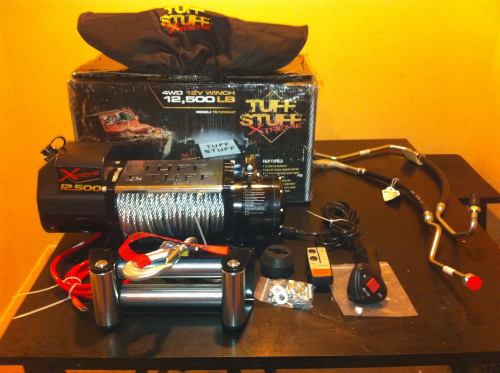

So guys I bought a winch while waiting on my tactical rover bumper to come in. I searched on here and didn't see anyone while in my readings talk about the tuff stuff brand winch? I haven't even seen discussion on it. Jeep and bronco and other owners but no rover.
Has anyone used a tuff stuff winch? I got the 12500lb extreme which is the waterproof version. I know it's a Chinese made winch but it has received good reviews from owners with equally heavy or heavier vehicles.
As soon as I figure how to post pics I will but it came with- winch, 88' 3/8 cable, Clevis hook, rubber bump stop, wired remote and wireless remote, and with a 10' tree saver for 400$ shipped.

Here's a pic I have a pic of the spec sheet ill post it momentarily.(link below)
