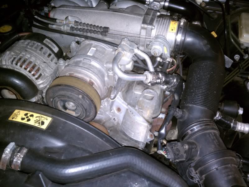

Hello everyone. New guy to the forum & new to Land Rovers but not to autos or German engineering (Bimmer guy too). I just acquired an 02 Disco II from a buddy. This is vehicle #5 so I'm forced to do all my own work. It quit on him one day after a round of golf. Before I get started cleaning up his and 2 shade tree mechanic's mess & fixing this beast I had a few questions. I'll just number them to make it easier to read.. Sorry for the dark Droid pics. By the way, CPS has been replaced & I just downloaded the RAVE manual.
1) What would go (or is supposed to go) next to the a/c compressor? Opposite side as alt. Pic below..

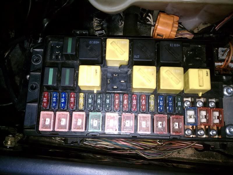

2) I sense I'm missing some relays. R6 had the relay cover off so I put the yellow one on it I found laying under the hood. Anyone have a part # for it? (only yellow relay on top row)
3) Is there supposed to be a relay in R9 (far right, top row)? What about R4 (fan I guess)? Any other relays I'm missing? (far top left? wth is that?) Pics below
4) Is the orange plug between the fuse box and coolant overflow the Land Rover diagnostics plug or is something supposed to be connected to it?

1. That is where the ACE (active cornering enhancement) pump would go, if equipped.
2-3. I don't know off the top of my tired head. If nobody has answered by tomorrow morning, I can spend a few minutes in RAVE and get an answer.

2. Relay R6 is for glowplugs (diesel only)
3. Relay R9 is the Main Relay, yes it needs to be there, but it is not the far right in the top row. It is the 4th from the right, top row. Relay R4 is for the cooling fan. All of the relays in the 2nd row (all yellow) have the same part number on my vehicle. If relay R8 has the same part number printed on it as the other relays in the 2nd row, I would put it in position R4 for cooling fan. R8 is for the heated front screen which you don't have. Relay R14 (top tow far left) is for ACE (active cornering enhancement, which you don't have)
4. The orange connector is unplugged on mine also. Through RAVE, I found it to be connectors C0377 and C0391, which according to wiring diagrams, are for the ACE (active cornering enhancement) block valve.
