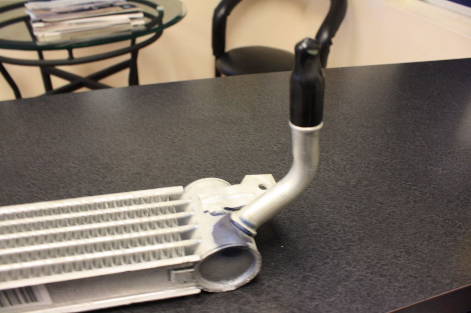

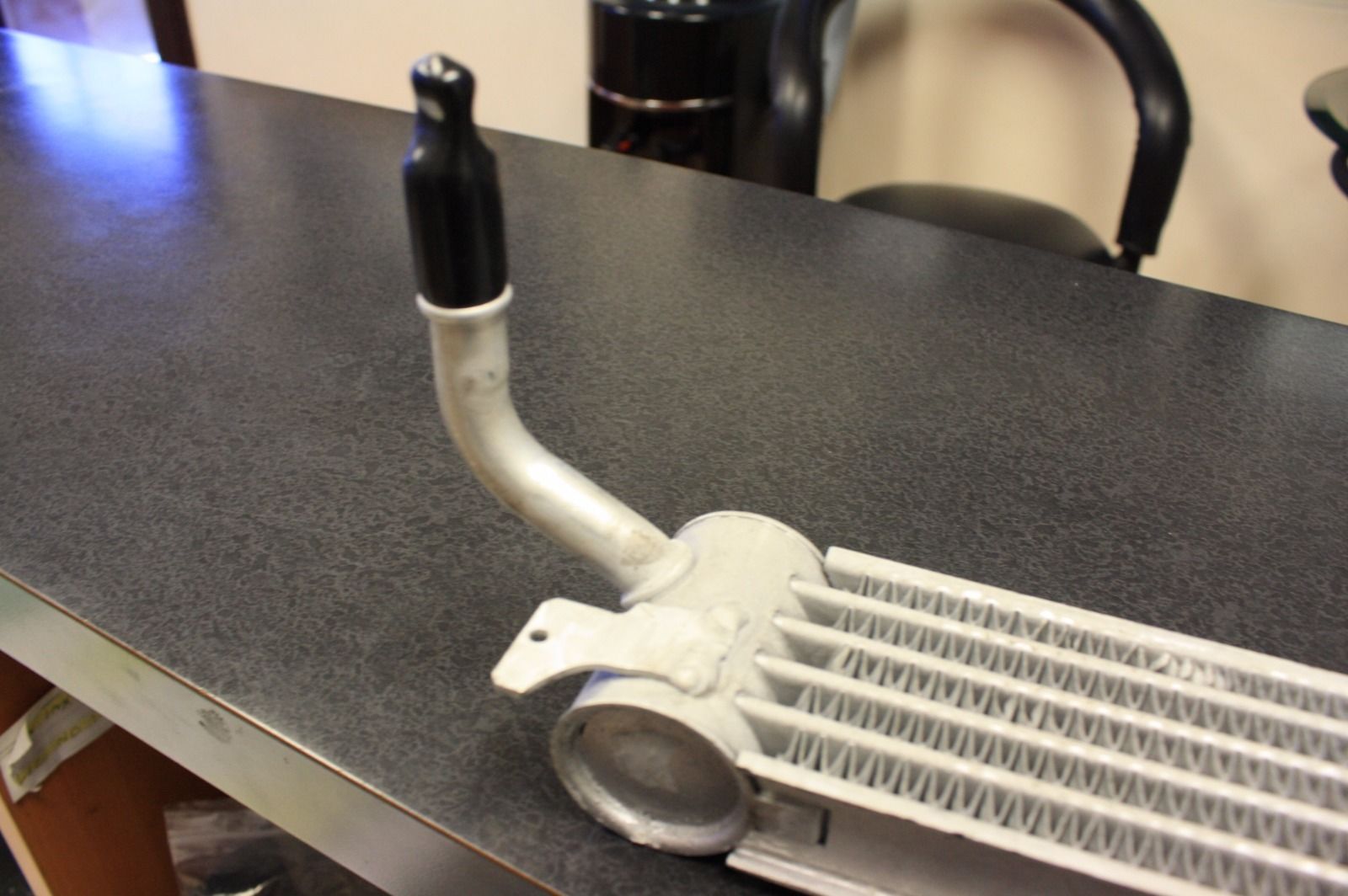

I found a brand new oil cooler on Ebay for Discovery 2(early model) and made an offer of 45.00 and he accepted. Went ahead and purchased two cooler lines and will install when they get here.
I have had a leak from on both of the plugs that were installed where the lines go, and figured an oil cooler can not hurt anything.

very wise decision....especially where you live........
