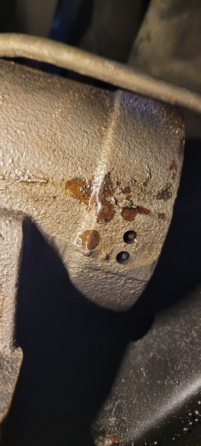

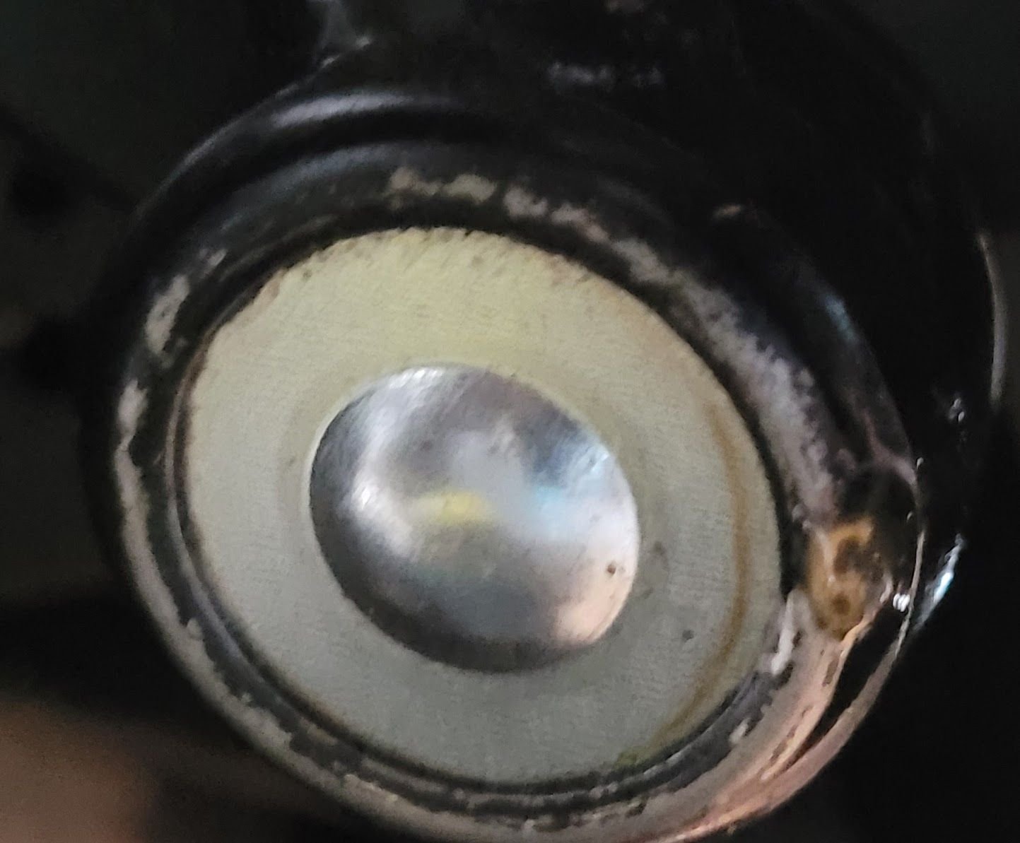

It looks like I may have a leak at the output shaft. Its a bit wet. But I think I am getting a leak at the two holes below, the fluid drips at the pair of holes, drips on to the pittman arm and on to the steering link. Just poured a few ounces into the reservoir and within 30 min it leaks out, with no pressure on the system.
Given I likely have two leaks, the pair of holes and the output shaft seal, maybe just need a new steering box.
Is that possible, do those holes go through the body of the steering box?

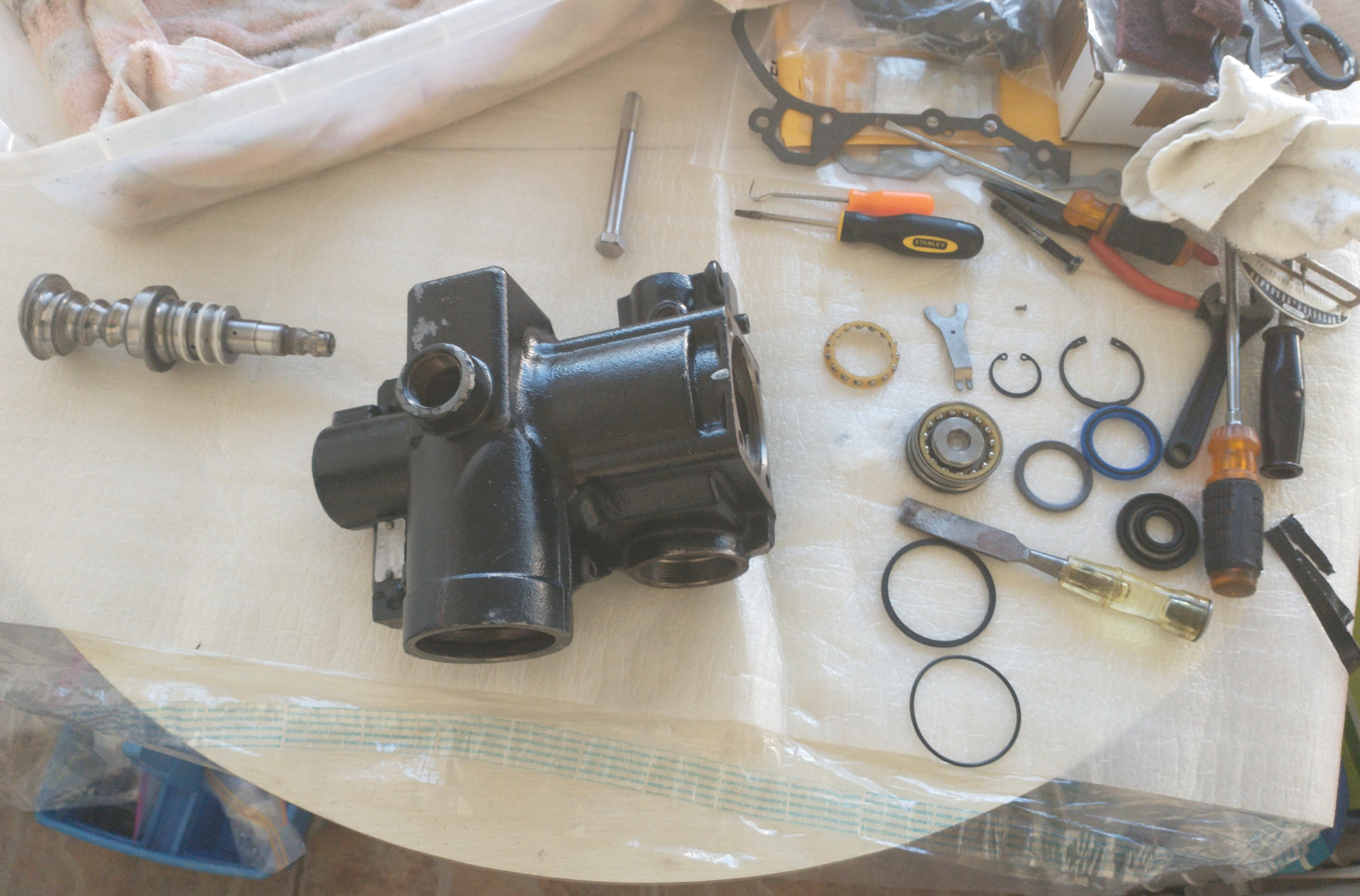

IIRC, on the box you sent me there is piece that goes over the end of that cap. The end of that piece of metal has 2 clip ends that fit into those holes to lock it into place.
The piece of metal at the end is used to secure the cap in place. Some boxes have it, some do not.
Here is the pic of the box you sent me disassembled:
Note the fork shaped piece in the mid/right portion of the pic

The cap that goes into the bore *SHOULD* have an o-ring on it. Perhaps that o-ring has failed. and yes, those 2 holes in the case go right thru the bore.
again, going by memory, the cap when pushed into the bore should be further in than those 2 holes. that fork piece keeps downward pressure to keep it
from backing out. Note that there are 2 styles of cases...one that has the hydraulic line going into the side of the case and one (like the one you gave me)
that goes into the bottom cap. the fork piece larger ends fit onto that hose to keep it securely in place.

just watching Mike's video again (brittaniarestorations)...there is a round snap ring that goes into a groove that keeps that end cap in place.
the one you sent me had that as well. is that snap ring present on your box and in its groove?
Old May 6, 2026 | 11:06 AM
mackendw's Avatar
Joined: Dec 2021
Posts: 316
Likes: 33
if the snap ring is in the groove properly, it's possible the open end of the ring is next to those 2 holes. IIRC, you are supposed to push the snap ring around in the groove
using a punch so the solid part is covering them up.
