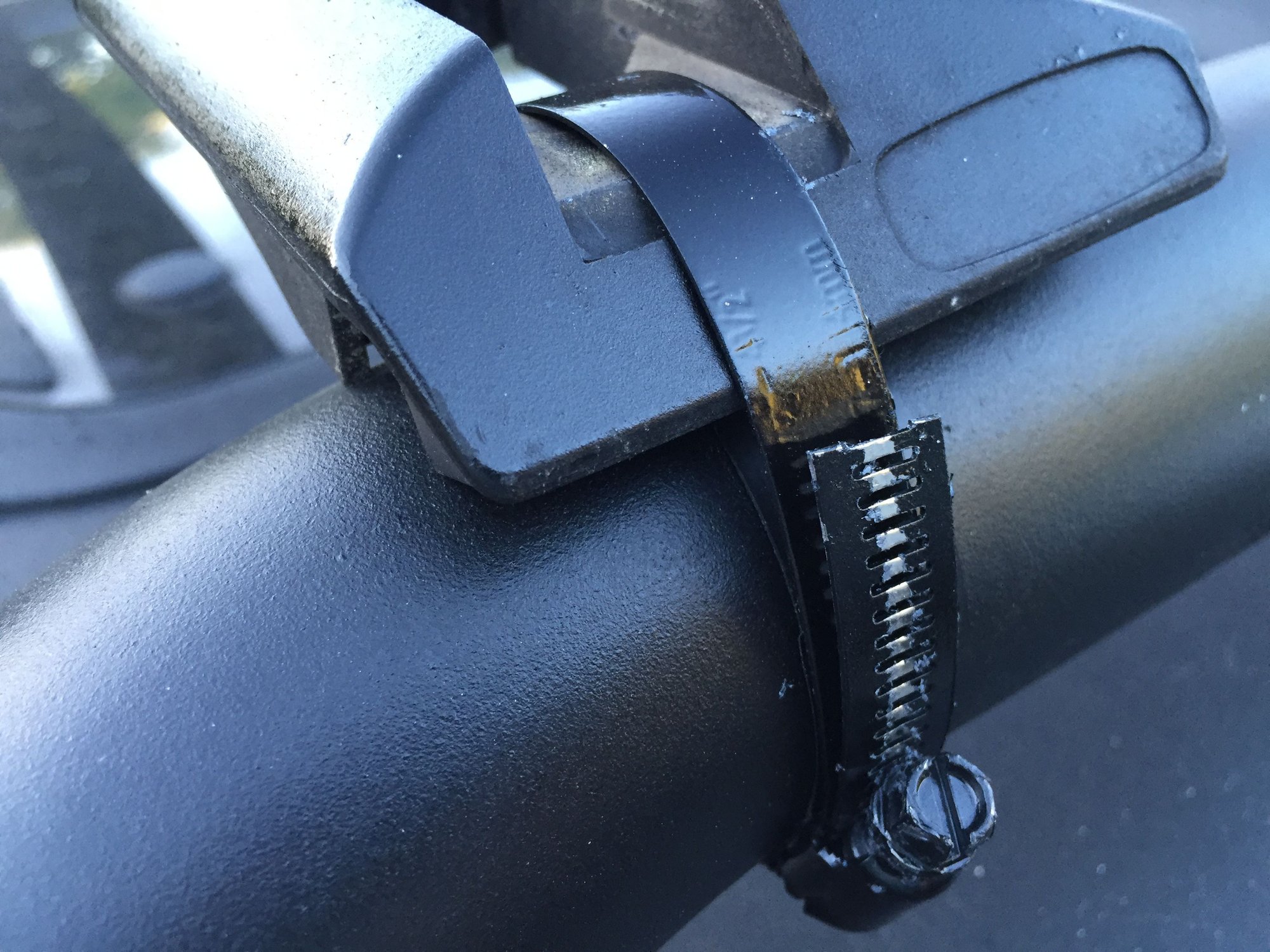

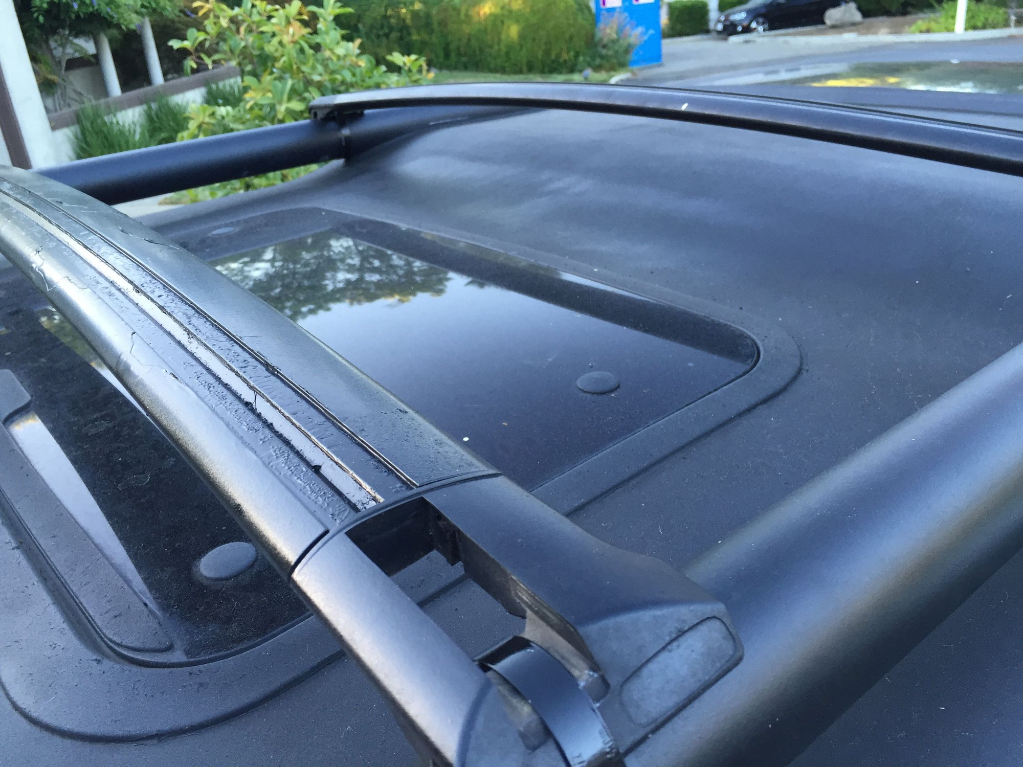

I ended up buying the cross rails for the old style roof rails from a junkyard for $25. I attached them with some black hose clamps. I was kind of skeptical at first, but they seem pretty solid. At least solid enough to hold a few skis this winter.

Here are some
I cut out the original locking mechanism so the hose clamp can go through. I also painted the hose clamps but they scratched up a bit after installation.
Great idea. Thanks for the pictures.

Actually came out pretty decent looking. Nice job!
