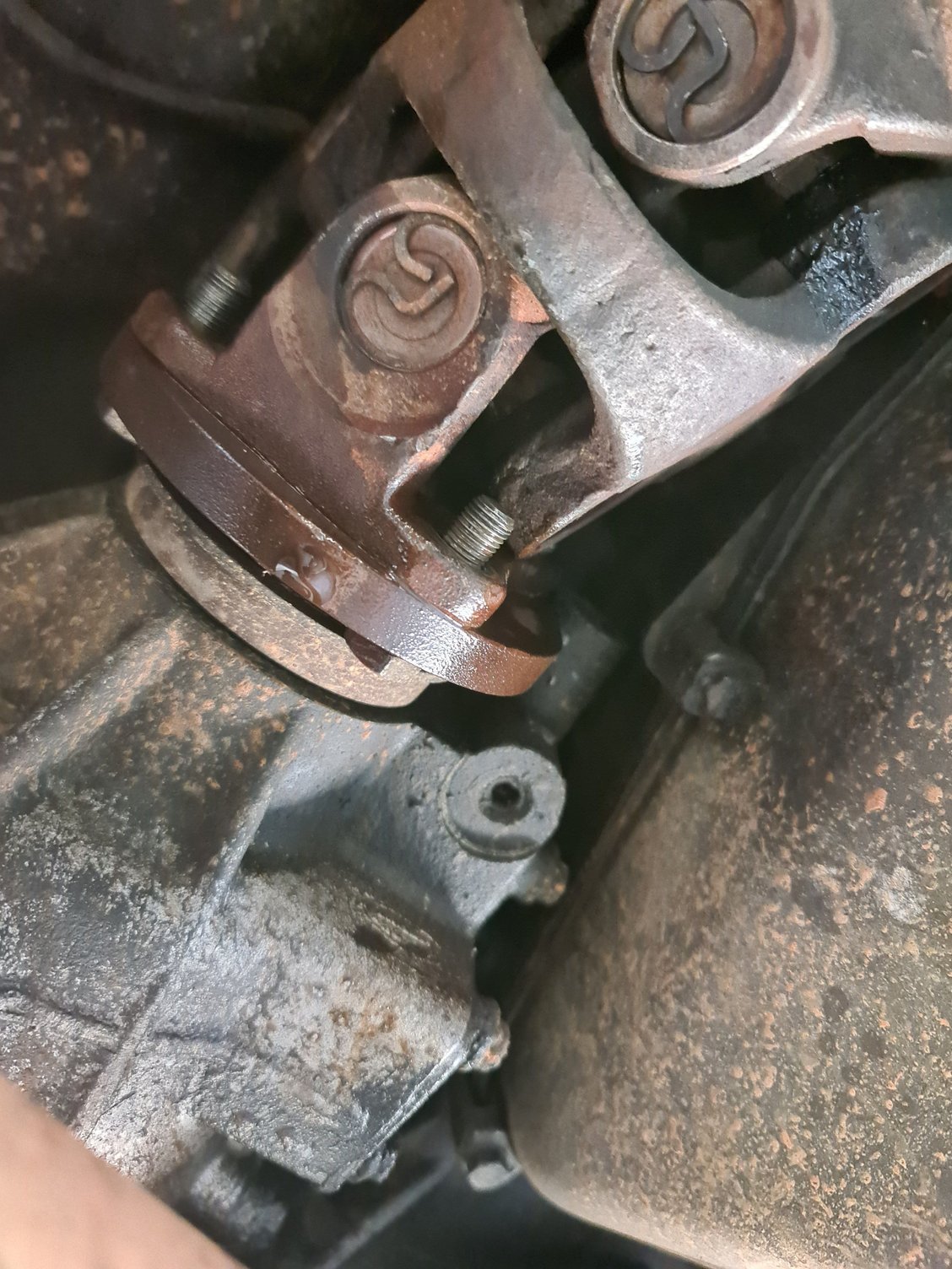

I just checked the driveshaft, never bothered to really check if it had nipples and it does, I relubed the front of the front and the rear drive shaft, still is chirping. Wasn't able to get to the nipple on the rear of the front shaft cause the nipples are too small for my coupler

The rear shaft joint lubed easily, not the nipple on the shaft itself
Turning doesn't change the sound, the chirping just gets faster or slower with speed
I thought it was breaks at first so I replaced all the pads and rotors
I lubed everything except the cardan joint and it still chirps, I'll have to take it off tomorrow

Now the rear of the front drive shaft won't come off
