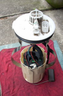

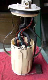

The fuel pump was running. It is easily accessed by pulling the carpet back, 6 screws in the access panel, the locking ring came off with a few taps of the big screwdriver and a ballpeen. A VERY light pry on the edge of the fuel pump (all plastic) and she will come straight up. (She will also be full of fuel, so have a bucket or... handy)
My keen mechanical eye told me that there were no broken wires, hoses, or anything else that I could see. Connected direct to the battery and she kicked on and ran. Sounded good. Put it back in. Reinstalling did not fix the problem.

Anyone want to rebuild my old fuel pump. read somewhere in another thread that it "only needs new brushes." It is the one pictured at the top of the thread.
