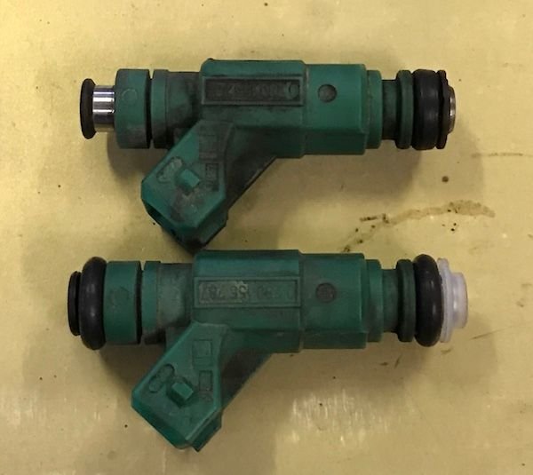

Pintle cap question:
Attached is a picture of an injector I just rebuilt (bottom), and the next one I was starting on (top). You can see in the picture that the new pintle caps are slightly different than the old ones. Anyone that has done this before know if this will matter? The old pintle caps extend just slightly beyond the end of the injector. They seem to fit well, and snapped right into place. I double-checked the kit I ordered to be sure it was the right one.

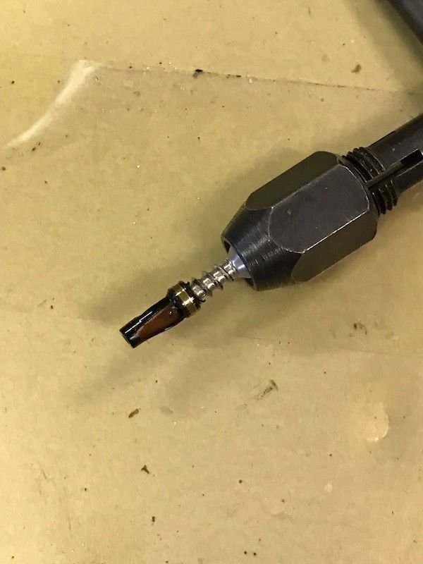

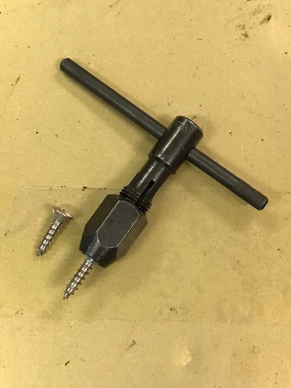

After an initial high idle on first start today, second and all other restarts (so far) are near normal idle speed. The rough idle is gone and running very smooth now. For anyone interested, I'll attach a couple pictures of how I removed the injector baskets. I can't claim the method as my own. Copied from a video I found. Worked well with a gentle wiggle and pull, after threading it in.
