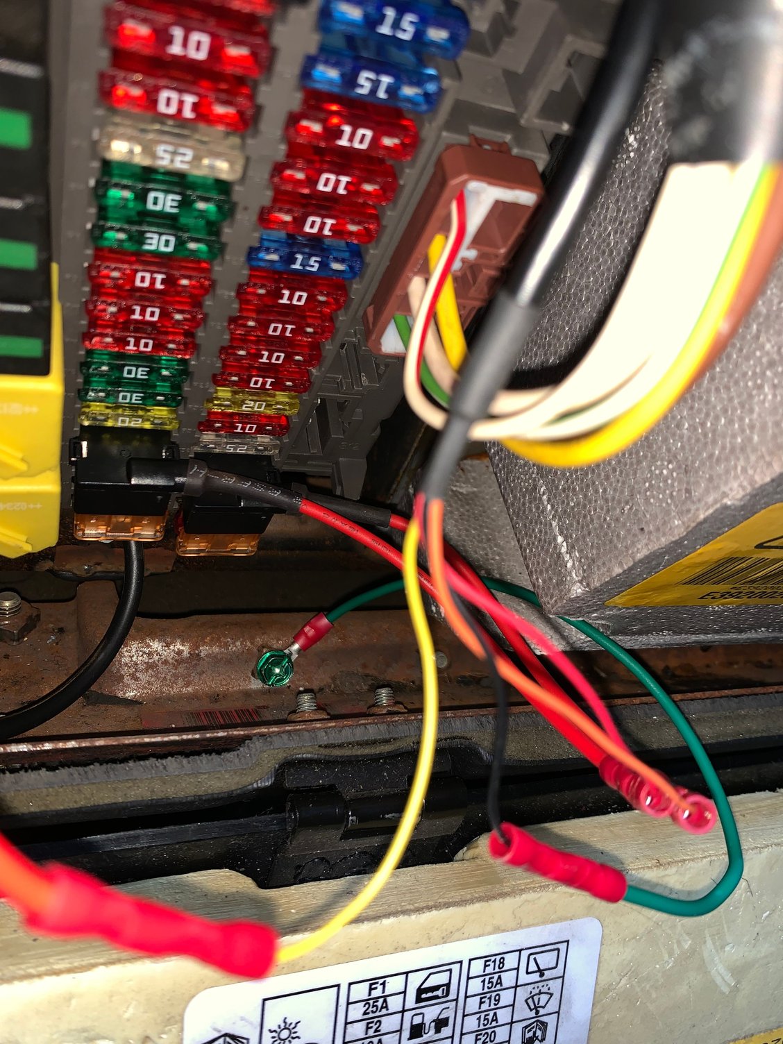

I ended up using the fuses as shown in this video -
Apparently some aren't truly constant as they shutoff when the ignition is switched, but F2 (fuel door) is supposedly a true constant... I really don't know any better and haven't started the vehicle yet to see what's going to happen (need to put the new oil pump on before I can do that) - I'll just see what happens at that point, but that's what this video advises. I used 5A add-a-circuit fuse taps - I'm not sure if there's a maximum they can handle with regard to the original fused circuit, but I believe all of the fuses are on 10A or 15A circuits... I'll find out a lot of things when I start the vehicle and see what happens - if any fuses blow, etc.
Yellow (Constant) - F2 - Fuel Door
Red (Switched) - F15 - Cigar Lighter
Orange (Headlamp) - F33 - Parking Lights
Black - (Ground) - this doesn't need to be fused - it turns out that I discovered the same grounding method that that other link shows. You'll just need a bit more wire to reach it, so solder or buttsplice some more wire on with a ring terminal on the end of the wire and put a grounding screw in that empty* welded screw hole shown in the link you shared.
*mine was empty and it seems it's just that way if others are doing that as well without making it so their dash is missing screws.

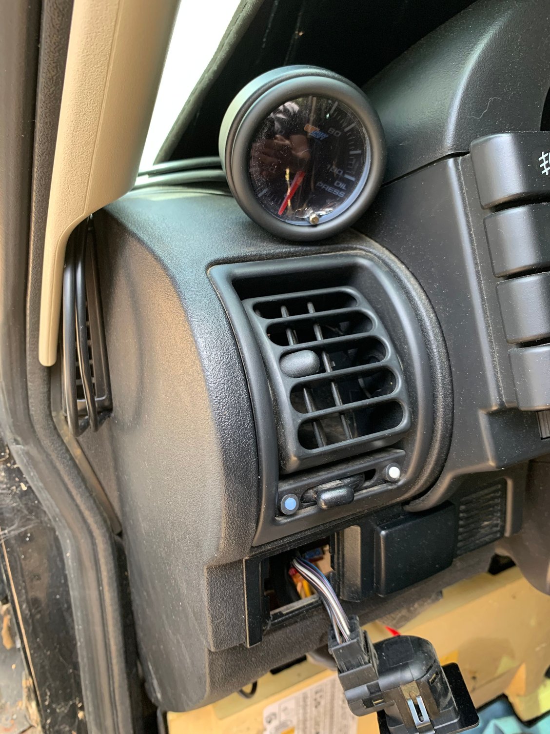

Hope that helps - by the way, I'm not any kind of expert, just sharing what I did after having to learn a lot to do this, which I believe is done correctly... I wish I'd just seen that video and that link sooner because I think I wasted a lot of people's time. If I were smart, I would have installed a water temp gauge at the same time since the miserable 18-22 gauge wire on the Glowshift gauge made it tough to get a good connection (tug test) using red buttsplice connectors. I'll probably cut them all off and solder/heatshrink tube the connections later after seeing that the circuits used are good. Another option is to install a water temp gauge at the same time so you've essentially got double the amount of wire going into the butt splice connector to give it a better connection when you crimp the buttsplice.
Oh yeah, I cut the blue buttsplice connectors off the add-a-circuit fuse taps (they all seem to come with 14 or 16 gauge wire and blue butt splice connectors) and used red butt splice connectors to be able to splice the 18-22 gauge wire from the Glowshift wire snake.

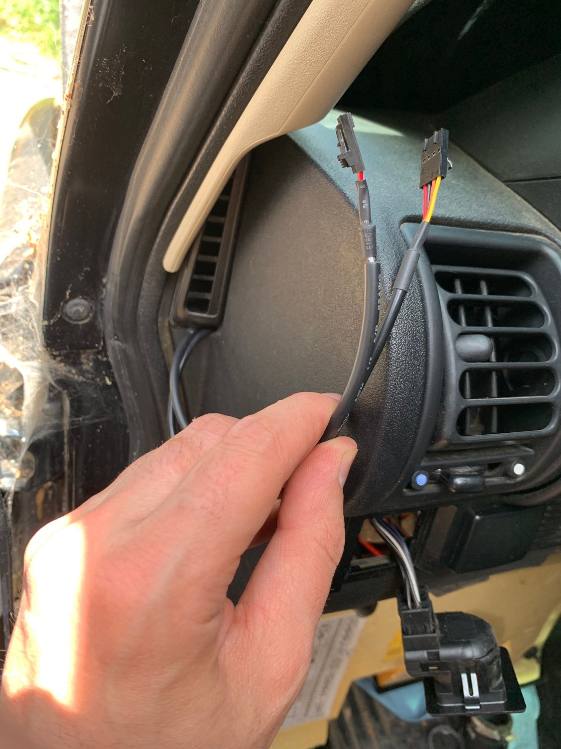

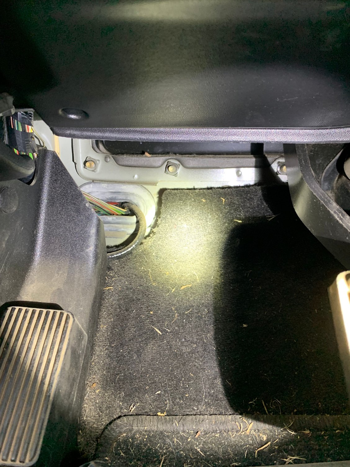

By the way, I didn’t drill anything in the dash, just managed to sneak wires as shown below, but it’s not easy and you’ll probably leave blood behind like I did. I’ll have have to convince myself if I really want to do any of that again for a water temp gauge - might just use OBD for that since you can get that data there (can’t for oil pressure, so you have to install a gauge). I ran the oil pressure sensor through the rubber bulkhead as shown and it sealed itself back up pretty well, but I’ll gloop some black silicone on there anyway. I plan to put the oil pressure gauge in the same type of mount that’s shown in the video - just stuck it up there for now.
