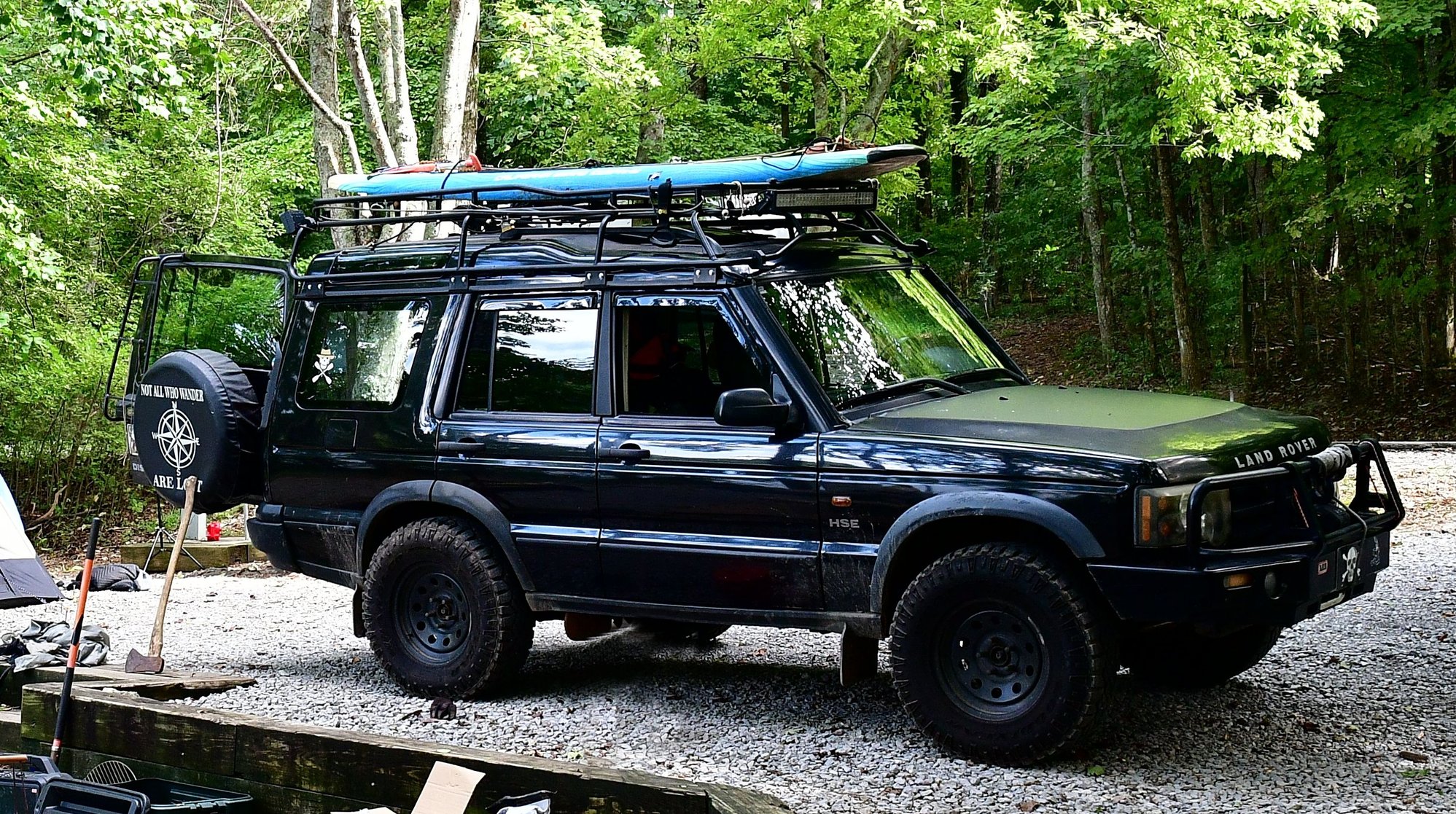

Hello Externet. Possibly a bit of overkill like always. My older remanufactured alternator failed test at two different parts stores since I needed a new one I figured I'd upgrade. I have been running in Odyssey 1500 extreme nearly impossible to keep charged having to put the smart charger on it a lot. Although I'm afraid I let it fall to undervolt and might have damaged it somewhat.
But I do have a really big winch up front a handful of exterior lights which I used to use often. I have a pump I use often for feeling inflatable paddle boards which draws far more power than it should.
When I get a chance my intend to replace all of my primary cables as they are probably original and pushing 195,000 mi
That big Alpine amps underneath my seat not sure how much it pulls combined with the 50 lb JVC base amp in the back.
I've been meaning to pull that JVC out of there since the day I bought it I just can't force myself to do it, but it do enhance the stereo experience. I've never noticed lights flickering driving in the rain at dark just impossible to keep the battery good in charged like it's not not enough extra juice. Big AGM batteries require at least 14 1/2 volts to get fully charged and mine has never put that out. It does now.
I'm fixing to make a battery change. will probably stick to AGM's but will run an Odyssey performance or one of the larger DieHards
