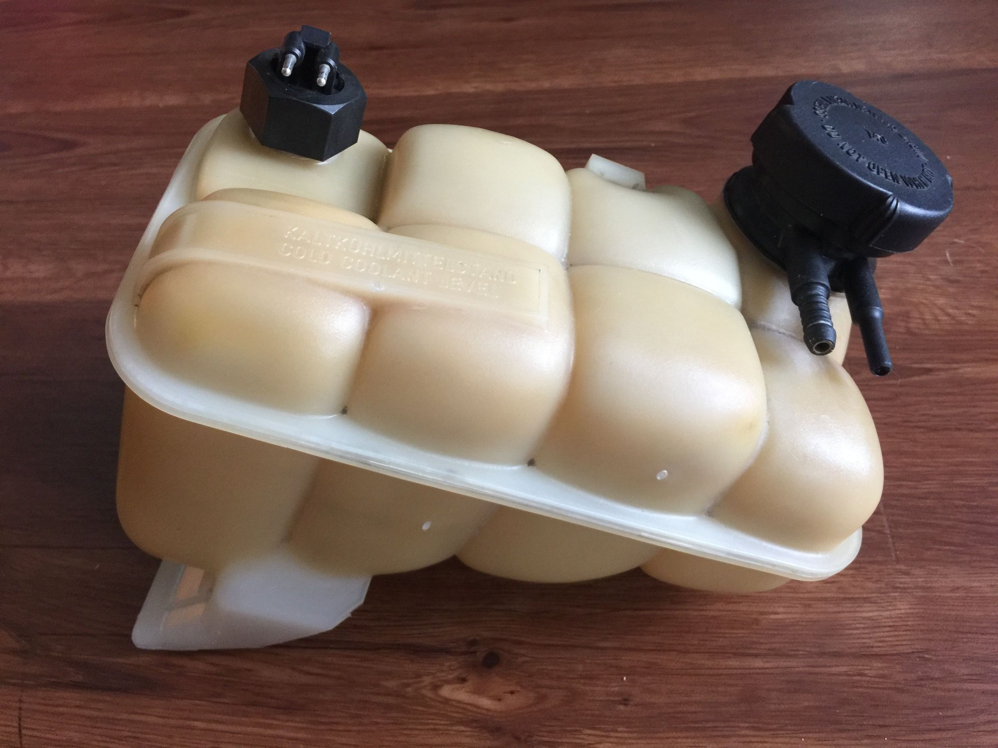

I didn’t want to take away from Alex’s cooling thread so I figured I’d start another one just on the 1990 BMW 325i coolant reservoir. Let me start off immediately with “if” you still have the OEM Throttle Body Heater plate then this mod isn’t for you as the BMW coolant reservoir doesn’t have the nipple on the bottom of the reservoir like the OEM LR unit. You “could” install a nipple where the coolant level sensor is, but that kinda defeats the purpose of this mod unless you just want the higher quality reservoir vs the much thinner OEM LR unit. Here are a few pics of the 1990 BMW 325i coolant reservoir.
It mounts the exact same way as our OEM units so installation is PNP. I will update this thread when I figure out how to wire in the coolant level sensor.

Wow! That's incredible how close that is. I can't wait to see it installed.
If one really wanted, you probably could add another nipple to the body. That said, TBH delete is the way to go.

do you double back your throttle body heater hose onto it's self or pipe it somewhere else?

With my current TBH delete I had a line running from the intake manifold to the OEM LR coolant reservoir. With this setup I plan on just plugging the intake manifold outlet and deleting that coolant line all together.

That's how I have mine. I used some 3/8" line and cut about half an inch off of a 3/8" brass punch to plug it.

Yep that's how I plan on doing it or while I'm working on the 4.6L V8 I have to install into my 04 (going to do HG/front timing cover while it's on an engine stand), I might take the intake manifold, cut off the nipple and drill/tap the hold and install a nice plug. It could be used for a future mechanical temp gauge as well. I'll end up with a spare intake manifold so if I jack it up drilling/tapping I can just slap on the 04's original.

Can't you just test the resistance on the BMW sensor against the LR sensor for variations? They both should work in the same manor -- When there isn't liquid to close the circuit, it'll trigger the sensor to be open aka light on the dash for low fluid.

There is no low coolant sensor on a 4.0/4.6L V8 D2

Thanks Juke, I had some time to kill the other day so I just went to a junk yard to look around. They had a few older BMW's and I'm always curious to find cross reference parts. When I saw that coolant reservoir I was like BINGO lol.
It's not perfect for every LR (with TBH's intact), but you could remove the temp sensor, and find a cap that fit, and install a 90 degree nipple on it and attach the coolant hose. It's a very stoutly made reservoir vs the LR unit for sure.
The bottom nipple for the main line comes out straight vs a 45 degree angle, but I just test fit it in the 04 D2 and a simple piece of hose can fix that.
