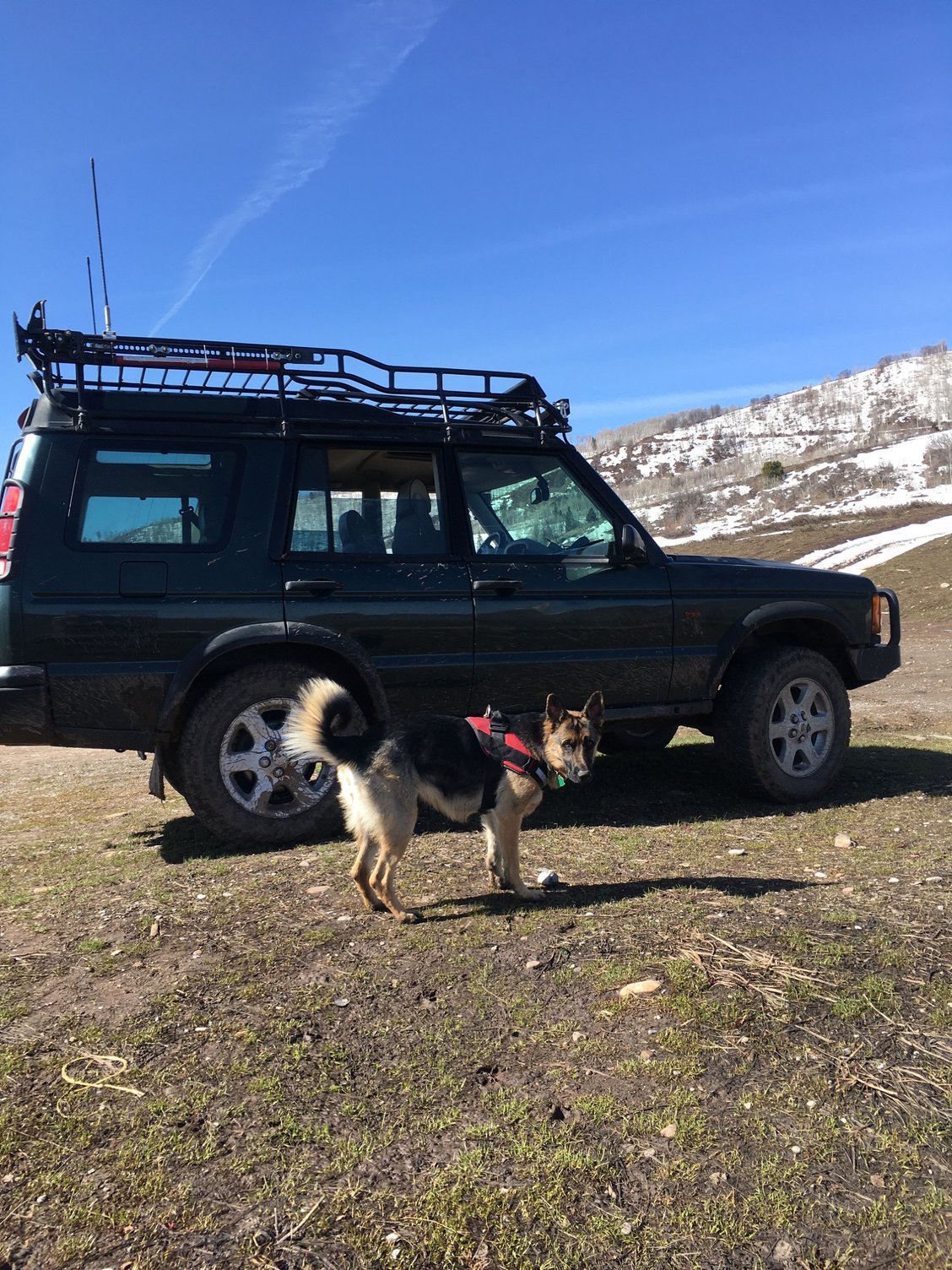

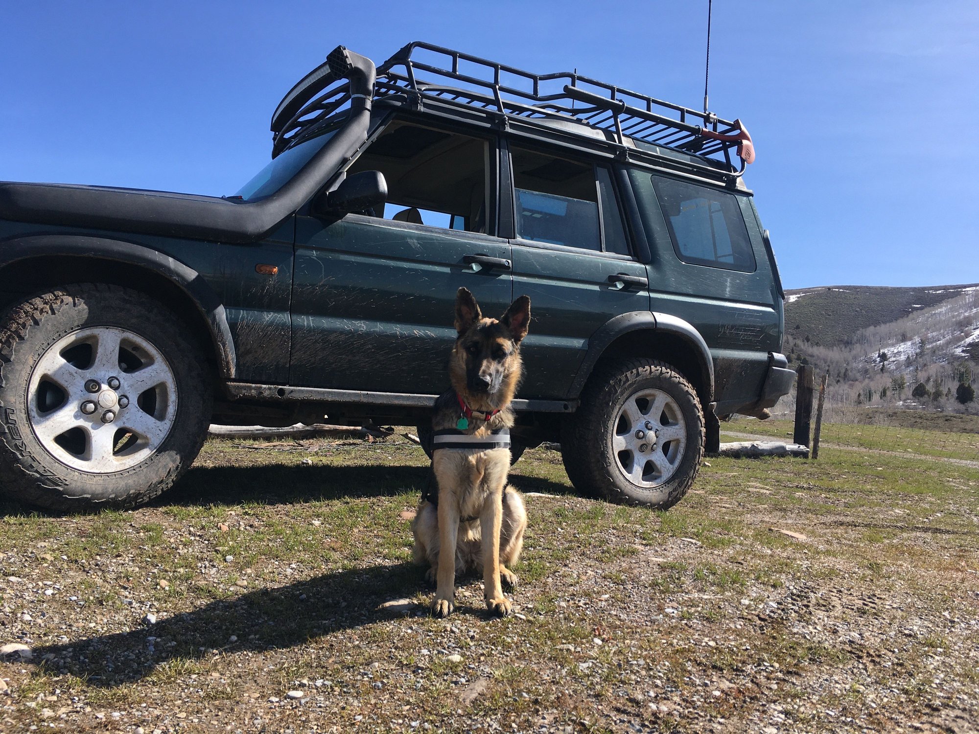

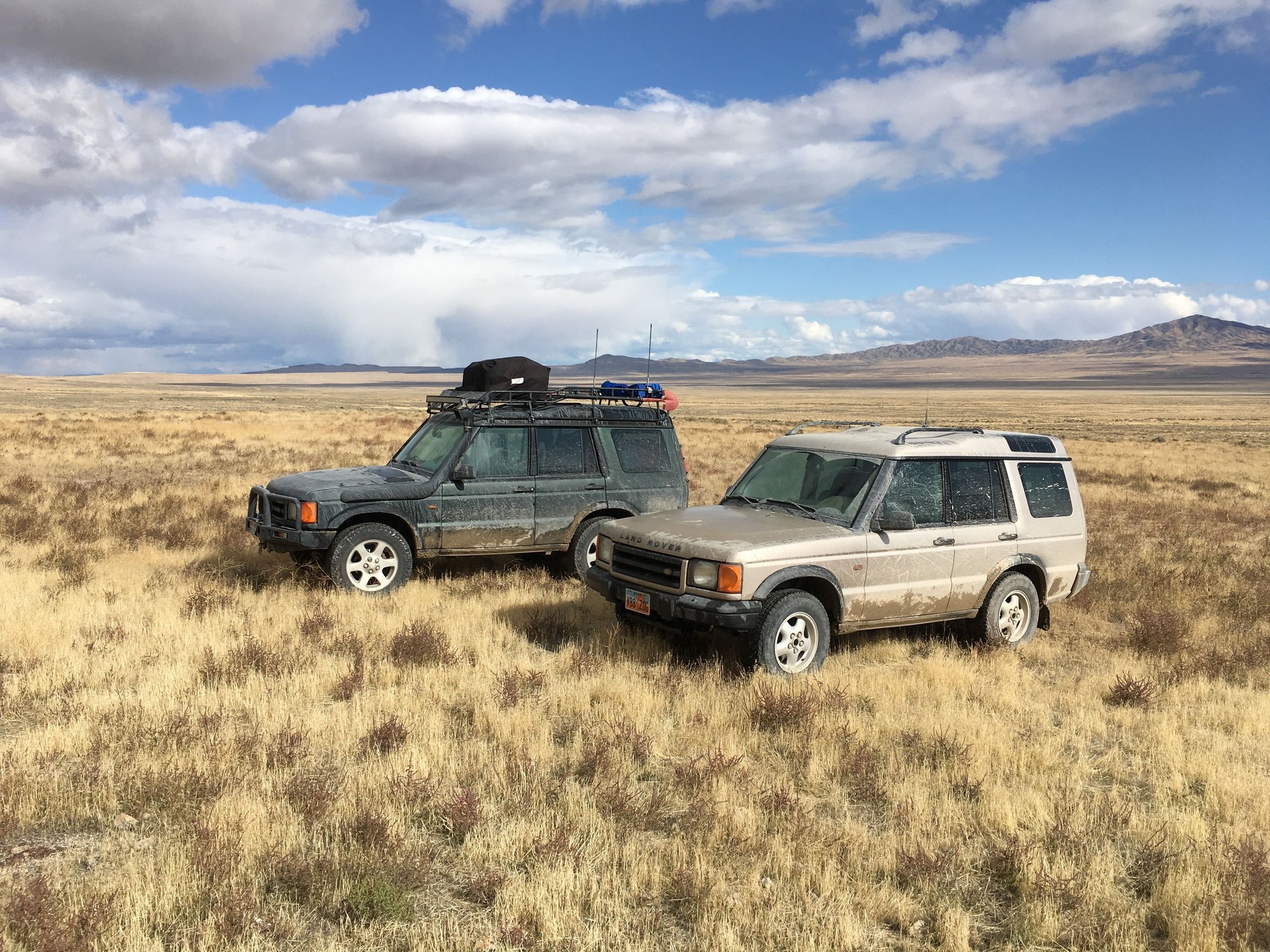

Originally Posted by T-rex
I'm running the Terrafirma 2 inch lift kit from Lucky 8. HD springs. My original springs were sagging a lot! The 2 inch lift felt more like a 3 inch lift - plus I'm running 265/65/18 Falken AT3 Wildpeak's that fill the wheel well much better than stock size.
Stock suspension and tires on the truck on the right.
The price was right and I've been really pleased with how the truck rides and handles.
@T-rex do you have any more pics from the side? This looks to be the exact look I’m going for.
