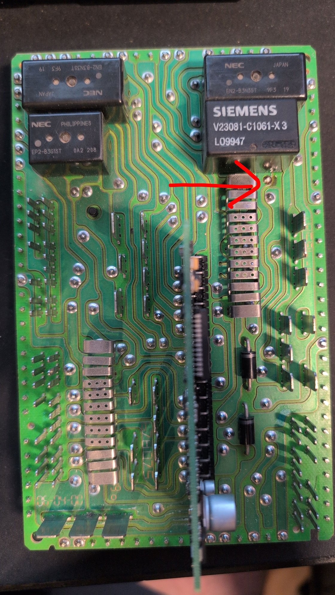

I followed Brandon318's recent post about a similar issue and decided to pull my fuse box and open it up. for anyone familiar with circuit boards does the above look like damage or something that could cause an issue?

To me the round dome solder looks like a repair. From what I have seen, the tent-like solders (pole in the middle with solder drooping outward) are what can be a problem. On the tents, the solder is thin enough that high current heats the solder, eventually melting it away in a dark black circle around the pole. A magnifying glass is useful to find the faulty solder joints, since they can be hard to see with eyeballs alone. The repairs I have done re-melt the solder and add more, that can create a shiny dome shape. More solder makes less resistance that gets less heat when current flows.
