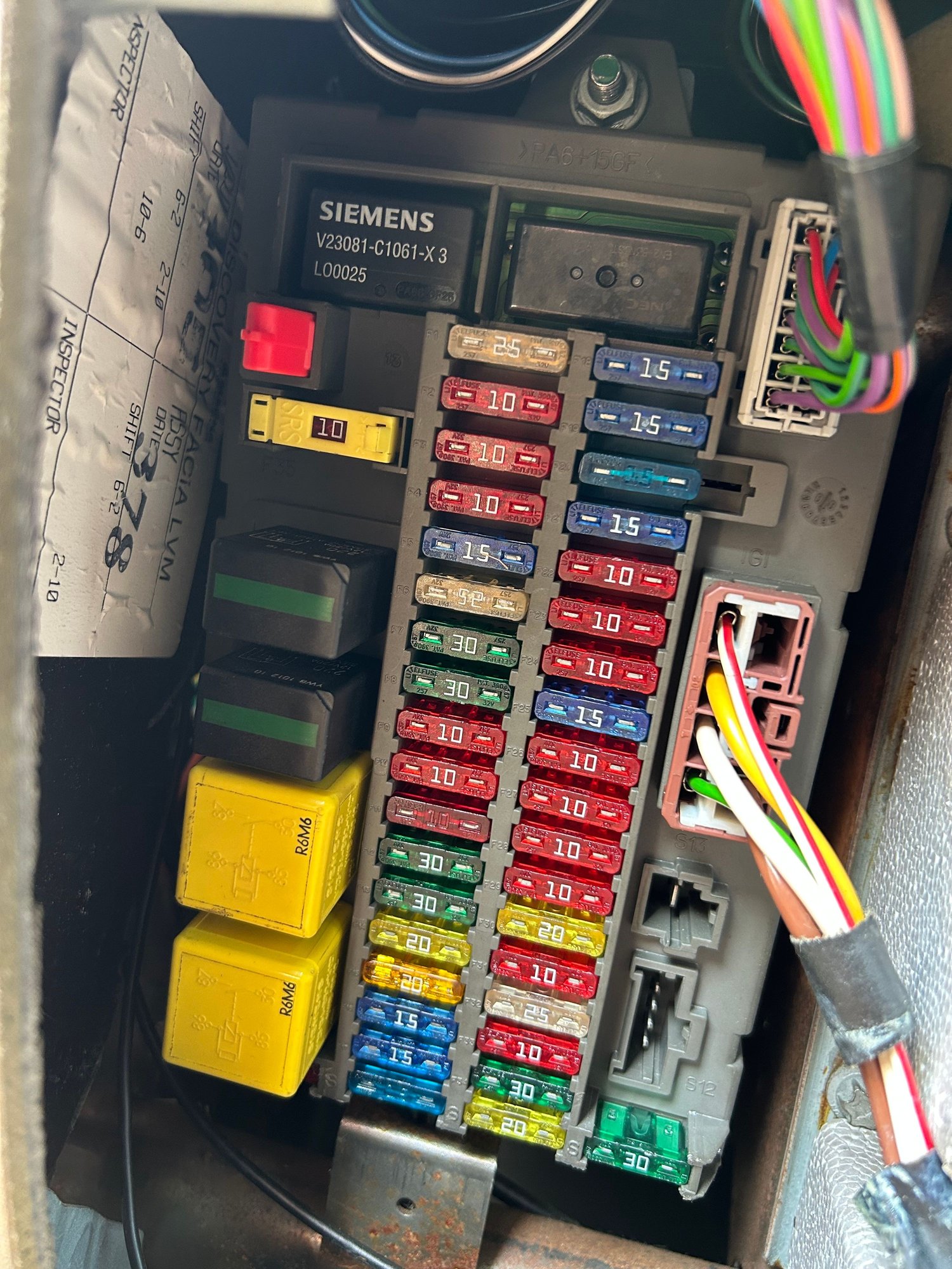

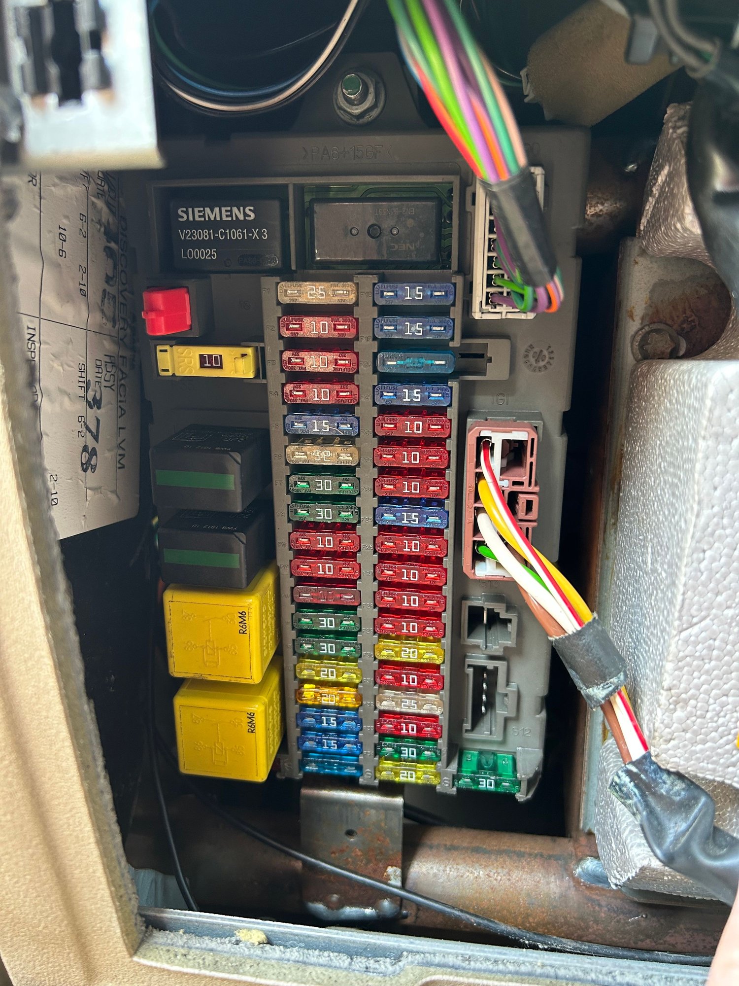

Hello all,
I have been following the forums for quite sometime and would like to thank you all for the great and help information that has been provided!
I have determined after some investigation that my interior fuse box YQE000410 is not supplying power to fuses 6 and 7.. No power to my blower motor harness....
My question here is part number for that fuse box is YQE000410 and I was told by Land Rover parts that I have to find that part for my 2001 Disco as the YQE000110 will work but some of the electrical operations might operate incorrectly. They would not specify which ones or to what extent.
I read on an earlier thread that these two are interchangeable, is that the case?
Thank you in advance...

I seem to remember 03-04 are different than 99-02, I keep both in my spares box. Just make sure you get one from similar year to yours.

I can confirm that the facelift years have a different box than the early years, and that swapping with the wrong type will not make you happy.

Because I tried putting the box from my junked 1999 into my 2003 and it mostly didn't work.
