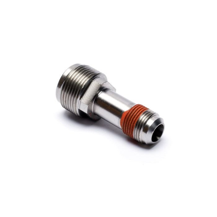

Those aren't part of the heads, so you may not know if they were there if you didn't have the engine in situ in the original vehicle.
With SAI, there will be two injector ports on each head, between the spark plug holes (beside two of the exhaust ports), as below:
The injectors look like this:
Most easily identified by the square faces under the threaded head.
