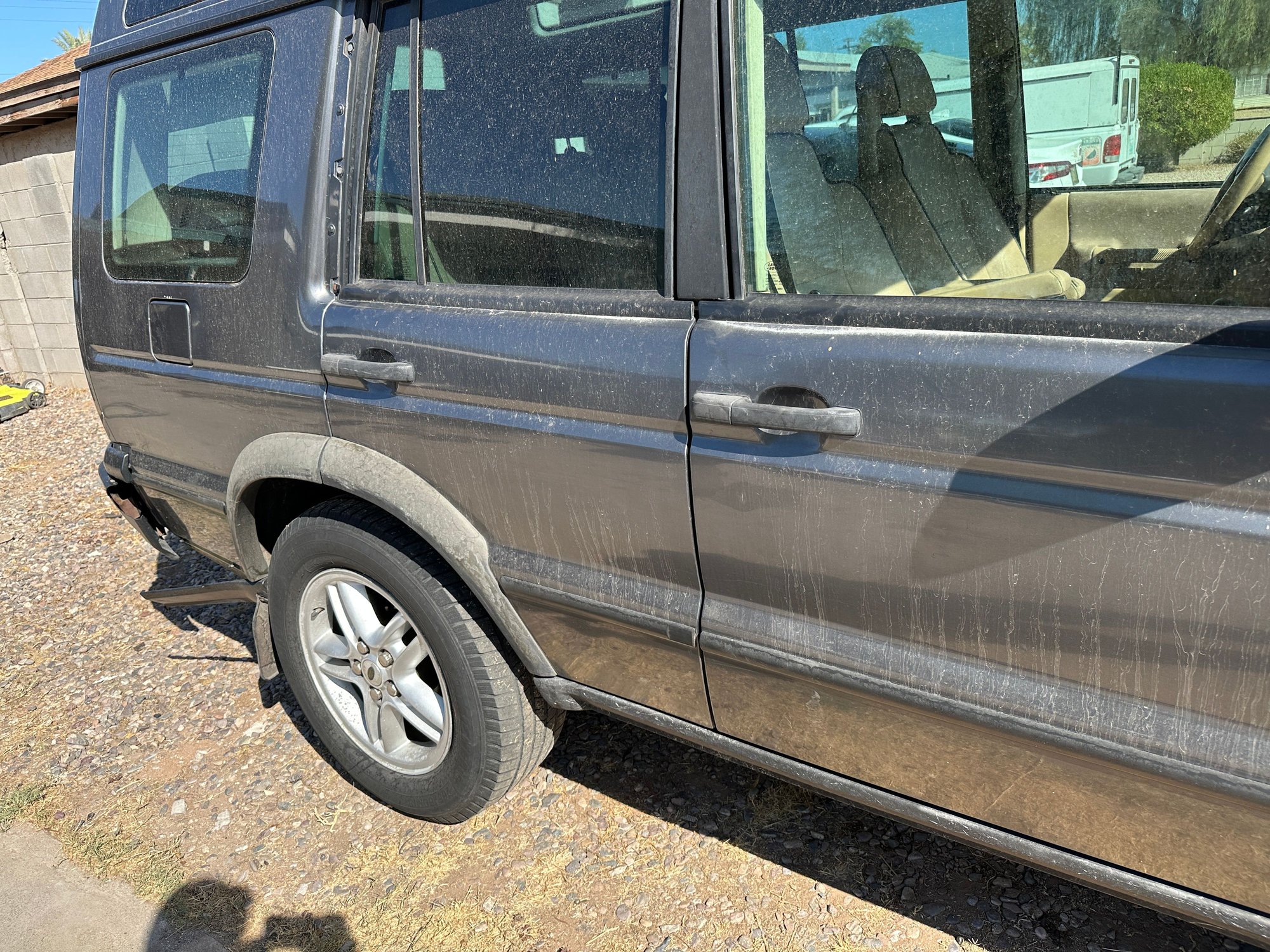

So I’ve been after a disco for an age. This one came up within budget and one of my mates is a mechanic and said “money pit, run away”
116k on the clock but I’ll admit the interior speaks to much higher or a hard life (plastics broken, seats don’t fully work, driver console/binnacle is held on by gravity alone and these are the fault codes:
P1884
P1481
P1300
P0303 cyl 3 misfire
P0300 random/multi cyl misfire
P1412
P1415
P0302 cyl 2 misfire
P0455 Evap leak detected (large leak)
P0102 mass air flow a circuit low
P0305 cyl 5 misfire
coil pack is in my skill set, head gasket is not…
appreciate your candid advice .

If it was cheap enough I’d buy it. Those are a lot of codes, and it looks well used. Perhaps the biggest issue to look for is frame rust, especially in the rear quarters.

No rust - AZ car, $2500 asking price.
is it expected that the inside looks like a angry kids toy box? I’ve owned higher mileage cars that look 150% less awful.
Not sure how these wear…
but googling the codes it’s either a head gasket or coil packs.. and as it’s 3 cylinders next to each other in the same bank…. Looks like a head gasket :-(

Me...l'd keep looking. Spend a little more for one that has been taken care of...especially interior wise. I'd not pay more than $500.00 for that one or less, paint is toast, interior you said is rough...and it may need a ton of engine work...run away.
